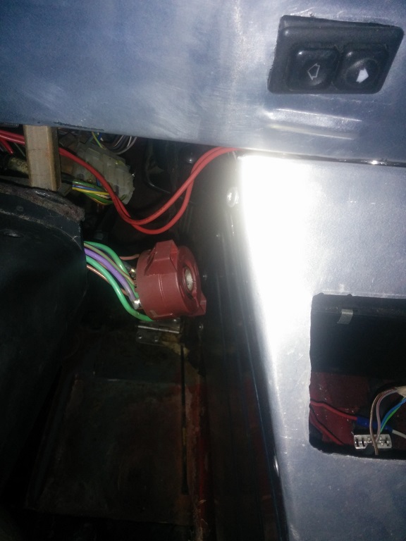

    So, not sure if anyone has done it or knows how to. But, wiring a push start with out using the key? This is what I have. Yes, there is indeed no dash or gauge cluster. Lol.

            Asking for help, looking for anyone with experience with the "push to crank" set-up.

              No engine in it at the moment, but I also keep it locked up in my shop and in the corner stuck behind two other cars as well. Strictly a track car, so it won't be out in the public either. Thanks for the concern though!

                No worries, its easy stuff. Here is the basics: when that black wire in the ignition switch gets +12V, your starter runs. I strongly suggest you use the stock setup if you can until the car is up and running.
                Do some design thinking, since this is a track car, you obviously plan on no key and switches only for power, right?
