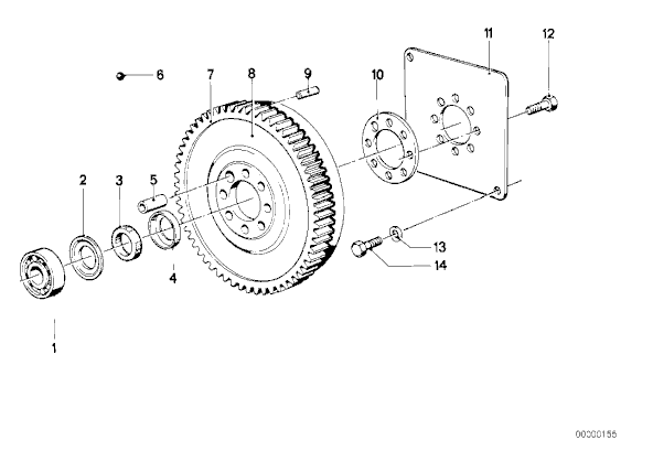

    I am missing #11 in this diagram, and that was my logic behind the spacers for the starter. Does this make a difference?
                That is for an automatic to bolt up the torque convertor. You have #10 and it is on the bolt head side of the flywheel?

                  Yes sir made sure of that
