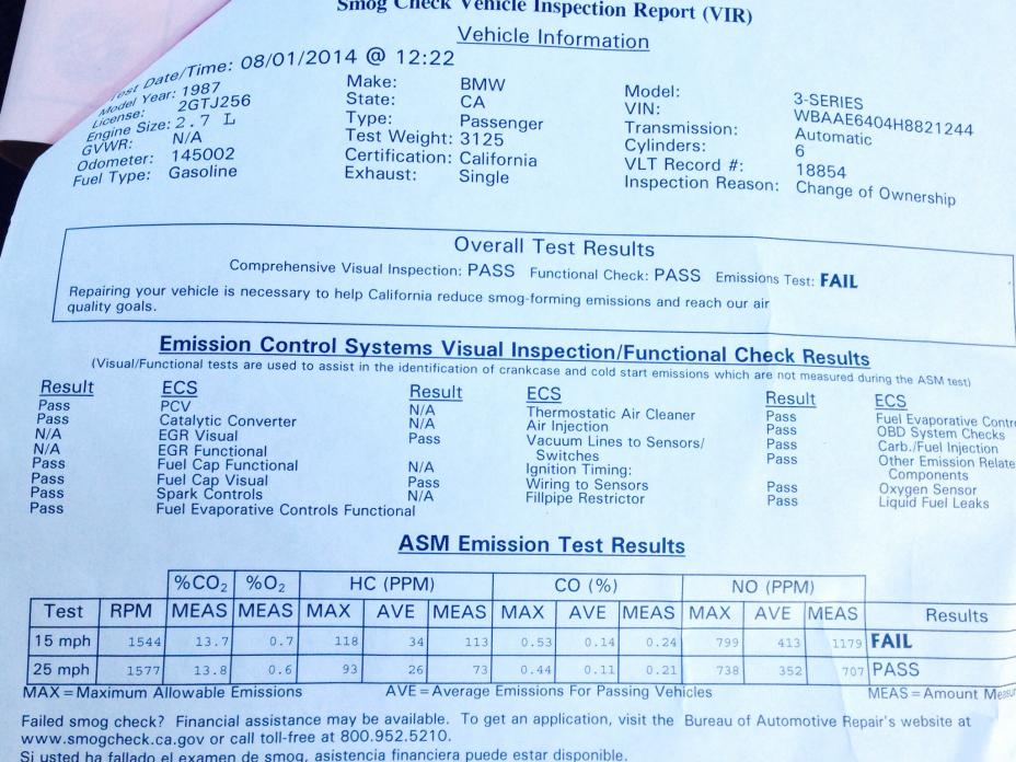

    A few days later I took to get smogged. After having done the previously mentioned work to the car I figured I would pass. NO.
    I failed twice in a months time with the smog tech saying "it's hopeless!"his co-worker concurring, " it'll never pass."

    Don't despair. The first thing you need to do is to get a competent shop to perform a smoke test for you. Fixing all vacuum leaks would help your car greatly. Do not do anything else until this is done.

      vacuum leaks or new cat will probably do it.
      o2 sensors are maintenance items.

        You're failing on NOX, and only NOX.
        I don't know how much it costs you down there to do the testing, but when I failed on similar readings, I went for 15 minutes of (very) spirited driving, retook the test and passed.
        What you want to do is heat your catalytic converter as much as possible. That means doing some high load, high RPM runs before going to the test. When you're sitting in line, keep your RPMs above 2k. Your car is actually very close to passing, so if the test is cheap, I say try the easy fix before replacing parts.

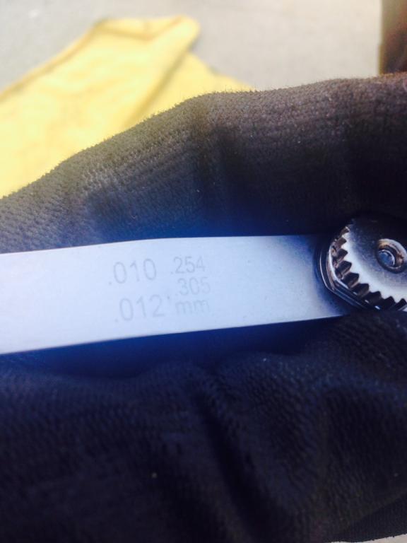

                I readjusted the Valves for a third time this month. I took my time and adjusted each hammer? Well let me tell you, those hammers could kick Thor's ass because thy were adjusted perfectly. However, the noise persists. I think it's worsened.
                Here's a picture of the feeler Gauge I'm using. I hope to god it's the right one I've been using this whole time.

                    your only issue is an air leak. that's why you are failing the 15mph and almost failing the 25mph. for NO only.
                    check your air boot, just but a new one, they are only like $15. that and check to make sure your oil return tube has not slipped down. this tube is on the driver's side of the block, under the intake mainfold and is 1" in diameter. grab it and twist upwards and make sure it's firmly seated. lastly replace your valve cover gasket and the 4 rocker shaft plugs. lastly if this doesnt work, you might have a break booster leak, seen it rarely but has happened. you will pass if you follow these steps.

                      You are wasting time and money until you fix your vacuum leaks with a smoke test.
