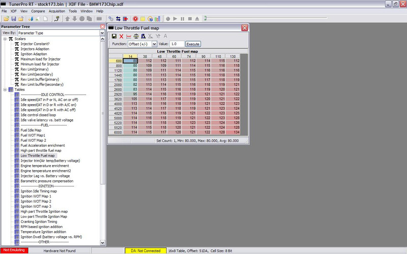

    I guess the problem will be here:
    I think the ecu don't give enough petrol at the low throttle map.
    Now i don't have an eprom burner, but i will buy one soon, and will try to fix this problem.
    Any other thoughts what causing this lag?

              If i can't solve this thing with the original AFM, i guess i will try with a MAP instead of MAF.
              Or maybe i'll change to standalone like megasquirt, but it's costs hellofalot money here in Eastern Europe.

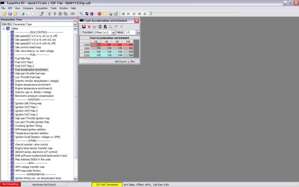

              A friend of mine said, the engine needs bigger injectors, because the Fuel acceleration Enrichment map is the responsible for this, and at low rpm's the injectors fully open. So i guess it didn't solved with the 19# injectors, i should go bigger. Maybe from a 328i dunno.
              I think the answer will be somewhere between the m20b20 and the m20b25 ecu's differences.
