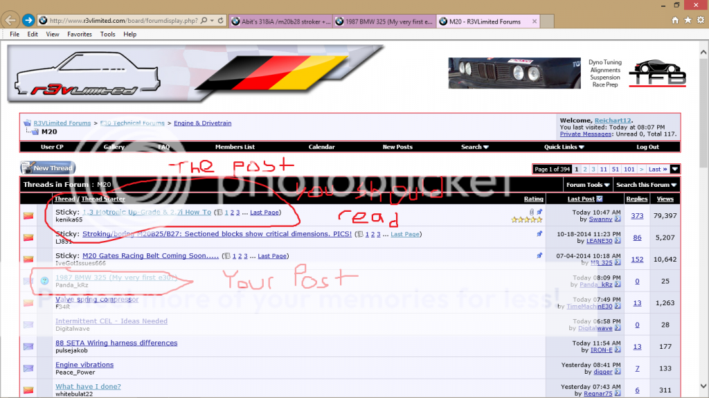

      I spit my drink out here, dang you broke him in quick! lol, read up on the swap, and just keep asking questions Panda just wear frame proof unidies!

        Lol, I don't mind the criticism and/or flames. I expect them, actually. But I did read it and now re-reading it just to make sure I haven't missed anything.
