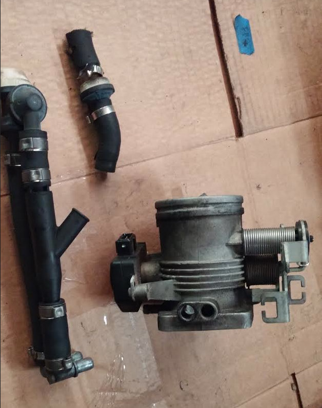

    Im wrapping up my motronic 1.3 swap on my ETA and need some help with a few outstanding items. I tried searching sticky motronic1.3 conversion thread but could not find anything specific to my issues.
    1. My I throttle body has a two holes for the dual brake booster hoses but one is blank. Could I use the upper vacuum hose that has the connection to the intake boot and just use E two nipple check valve (in the middle of pic)?

    figured it all out....
    1. I used my E booster single line and plugged the intake boot with a large bolt clamped on. I ordered the right intake boot with no extra hole for the dual booster.
