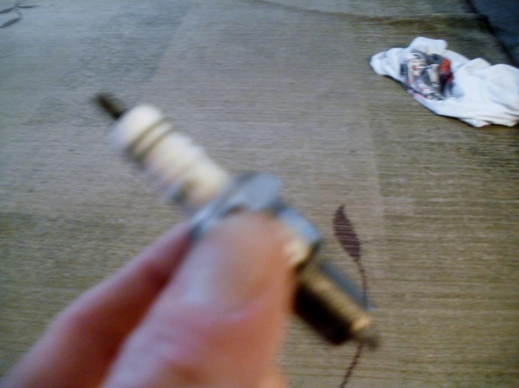

            • cpandrewschmidt
              • Oct 2014
              • 88
              I'll snap some pictures over lunch. I did post the part numbers for BavAuto's website. You can't copy and paste their links as the link only goes directly to their homepage for some reason.
              Thanks for helping, I'll update in a couple hours with the pictures of what I have.
              Andrew

                • cpandrewschmidt
                  • Oct 2014
                  • 88
                  Thanks, I pulled them over lunch. They definitely had that cap over that screw part. I removed the cap, re-installed and started the car. Started and idled fine, which it did before,. driving was where i noticed the sputtering. Haven't had a chance to drive it but hopefully that was the issue.
                  PS - why is that cap there then? I thought most new plugs left that on? Should that always be removed? I haven't really changed plugs in a LONG time.
                  Thanks!
                  Andrew
