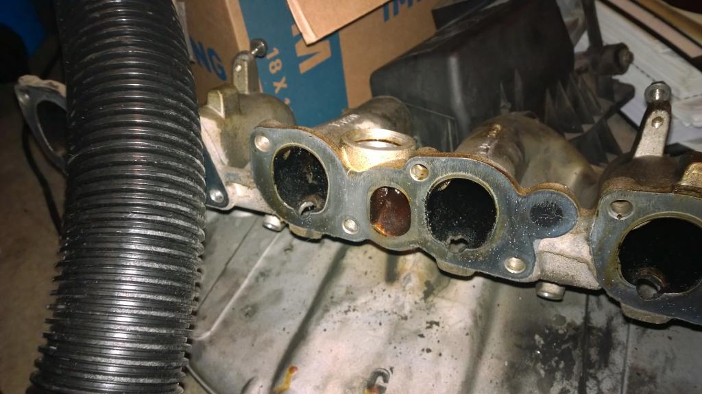

Hmmm, this might explain why it's idling screwy
    Sent my fuel injectors to mepeh, noticed some gunk on the injectors, so I pulled the manifold, looks like the oil return tube has been leaking for awhile, and the pcv has been sludging up too. Maybe that's why its been idling funky.

    new gaskets and such arrived today, injectors arrived yesterday, install starts tonight, we'll see how she idles now.
