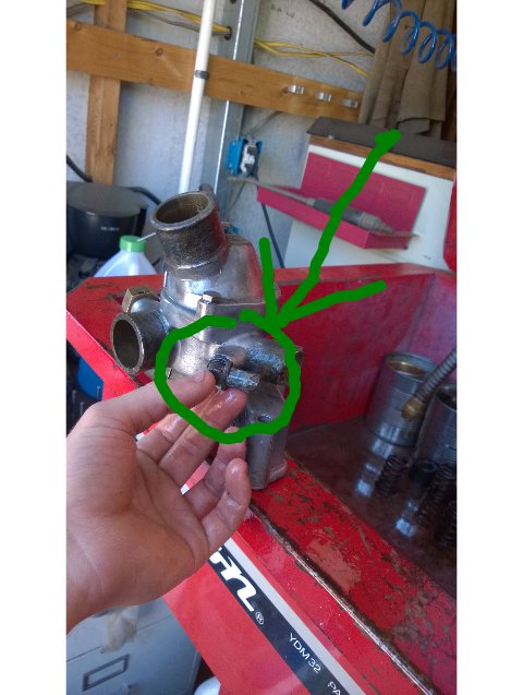

    Wtf is this arm off the thermostat for?
    I have the head off my e30 doing a resurface cuz I blew my head gasket like a dummy. I forget what hose goes on this arm of my thermostat housing, to be honest I dont remember even taking a hose off this piece. It was clogged so bad before I cleaned it. I may not have had anything on it but I want to know if there was something and where ot should be routed too. Thanks in advance for the help.
  • e30onBBSs
    • Dec 2014
    • 1347
    Looks like its from the m20, that hose comes from the throttle body, and wraps around and up to connect there. I may have a pic I will post it up if I find it.

      Its definitely from the m20 I just don't remember it goin to the throttle body I just remember the two coolant hoses from the water jacket connecting on the throttle body. I would love to see the picture though.

          goes to throttle body for sure
