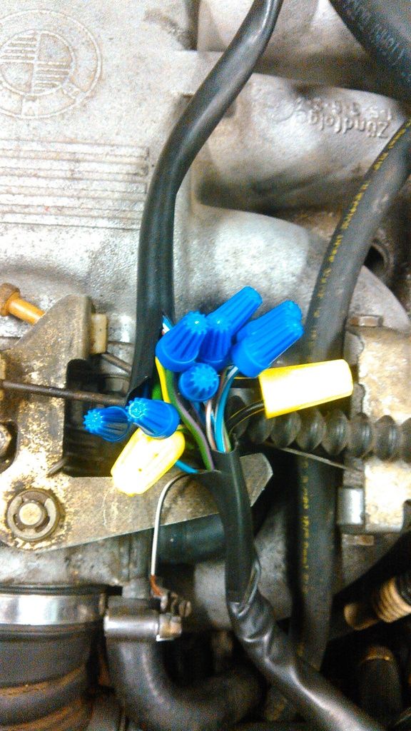

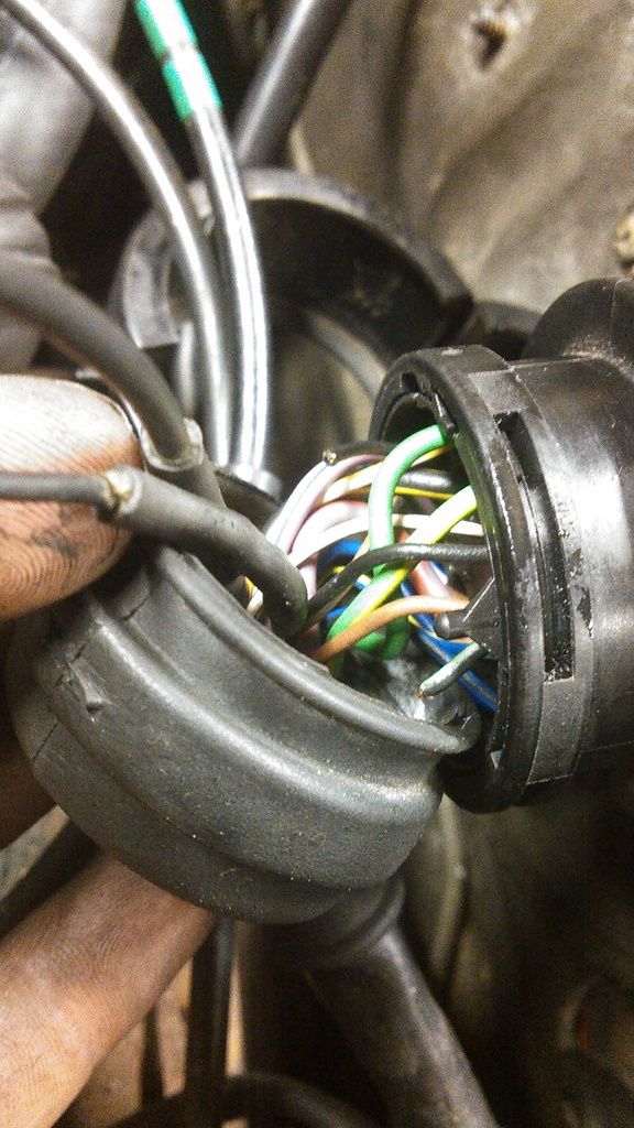

    Here are the chopped wires from the c101, they are pins 9 and 15

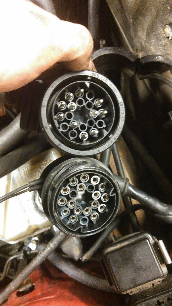

    Here is the c101 plug, the engine side has alot less pins then most of the other c101 plugs i have looked at
    Here is our splice (its temporarily spliced with wire nuts till we know it works), We followed 4 different wiring diagrams showing the pinouts between early and late, all the colors matched and left one Balck w/ white stripe wire left over

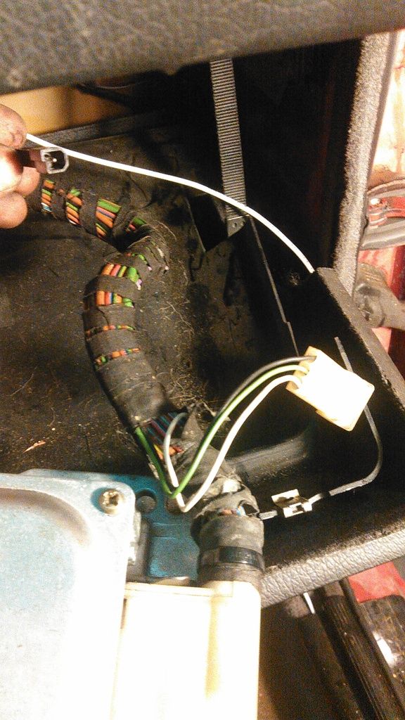

    Here is the three pin plug by the DME along with a little single pin plug thats a little farther back on the harness (there is actually two of these single pin female plugs)

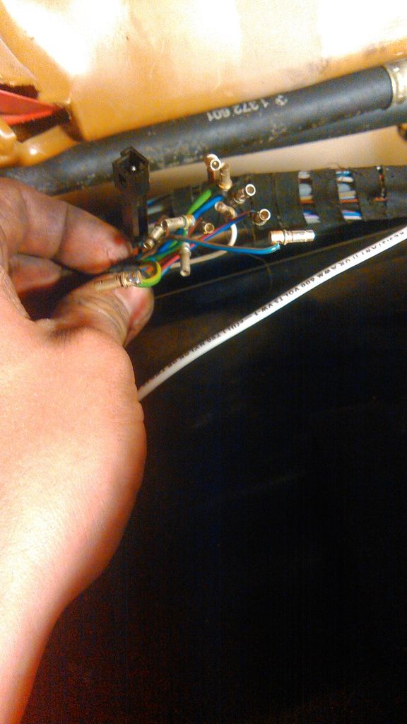

    Here is what i think is the pins for the little automatic transmission computer plug thing along with the second single pin female plug

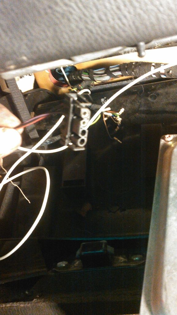

    Here is a blurry pic of the plug on the dash side of the harness (late model dash harness)
