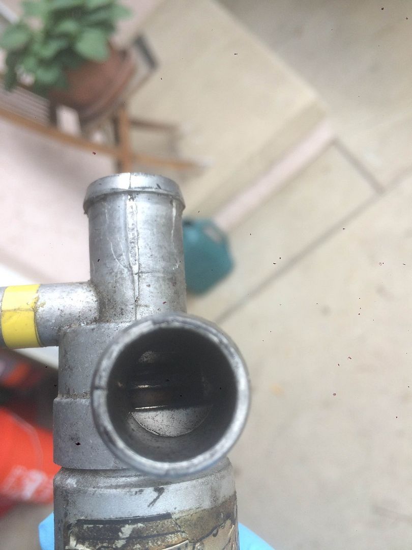

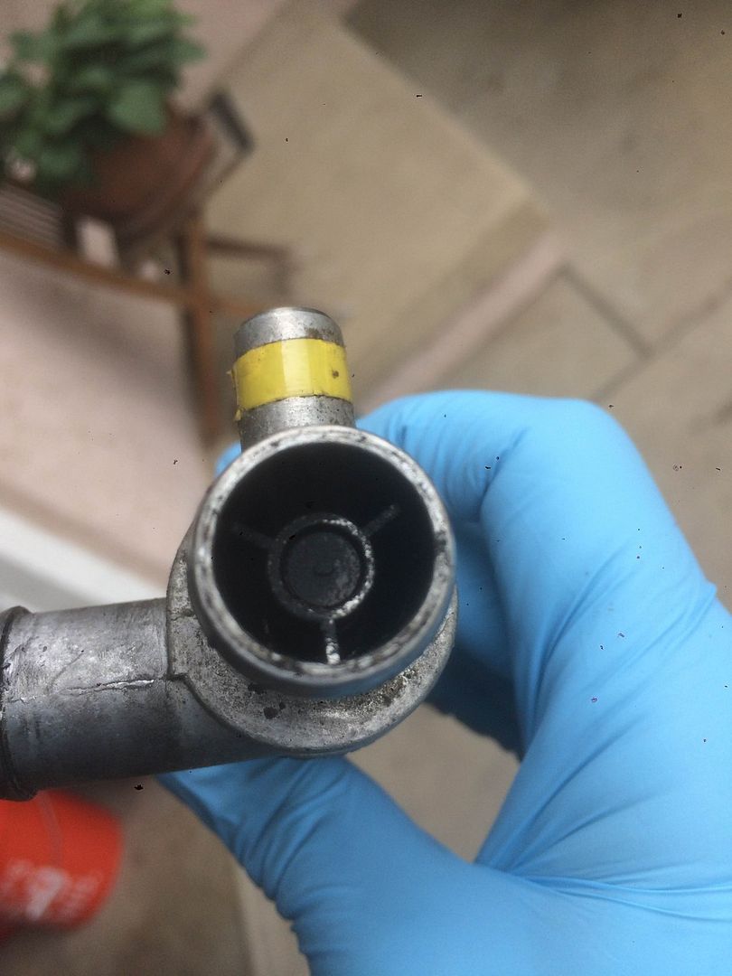

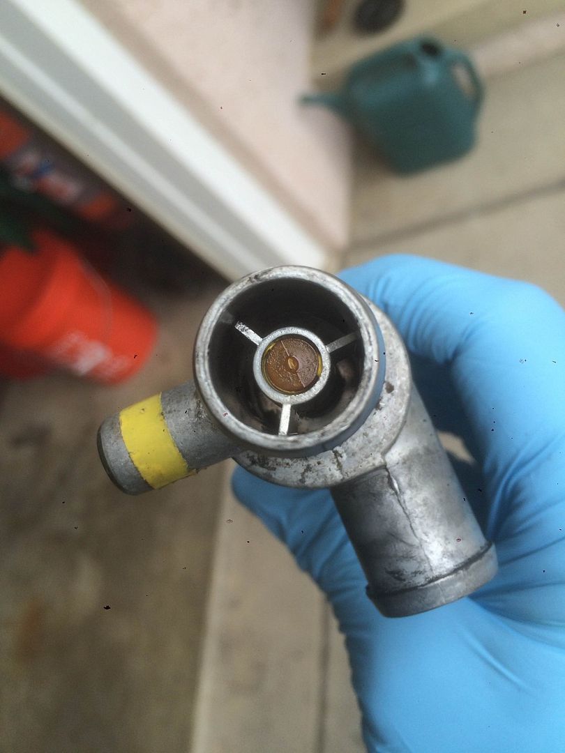

            I will pull the plugs in a few minutes, got bored this morning and pulled the ICV off and cleaned it out with some carb spray, I know this wont fix my problem, but it'll help when its running properly.
            BEFORE:
            [IMG][/IMG]
            [IMG][/IMG]
            AFTER:
            [IMG][/IMG]
            [IMG][/IMG]

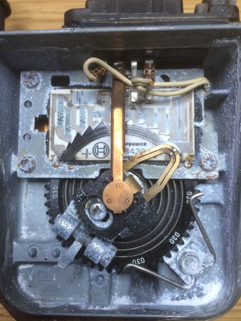

              I did get around to removing the cover of the AFM to do the common rejuvenation of the resistor strip contacts and heres what I was greeted with.....This is definitely contributing to a bad air/fuel ratio
              [IMG][/IMG]
              Everything is covered in corrosion...Time to start searching for a new AFM I guess

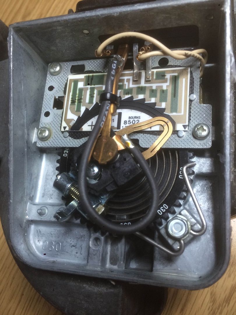

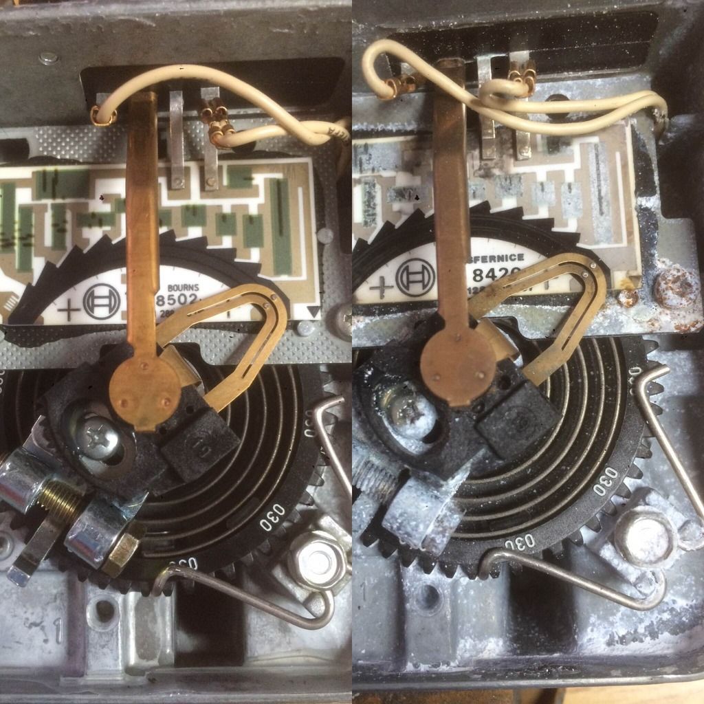

                      Finally got to updating. Got a new AFM from eBay super cheap and figured it was worth a shot. Turned out to be in amazing condition. Pulled it apart and did the usual rejuvenation process (Moved wiper arm to new resistor track and soldered wire to both electrical contacts. :D
                      First picture shows the comparison of the old AFM to the used one off eBay
                      [IMG][/IMG]
                      Next picture shows after the rejuvenation process
                      [IMG][/IMG]
                      Reinstalled the AFM and fired it up. Running 1000x better. Thanks for everyone's input! I already love R3V!
