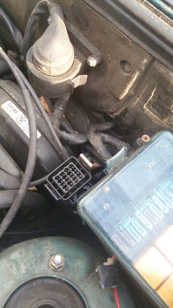

          I have not replaced any parts yet on this car, so I would not be able to tell you. Still sorting out issues. One of the fuses I replaced was the fuse for central locking system, which I believe was missing completely. I'm wondering if this was possibly intentional? I have no way of knowing, the previous owner is not mechanically inclined at all so who ever had done previous work may have done this. Also there's this weird wire and extra fuse just kinda hanging out from the box? And a terminal that looks like a relay or fuse should be there but is not. Is this normal of late model e30 verts?
