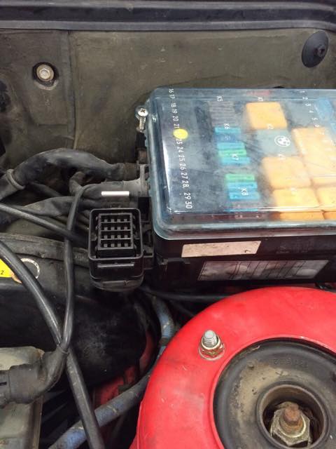

    Anyone know what relay is supposed to go right here, the mount is clipped to the fuse box. 90' 325is Click image for larger version

    It is not for any relay. It is a add on box for accessories. If you looking in it it should have 2 pins in it. One is constant power and the other is switched power. You would get the other pins from the dealer. Install them and add a fuse to run accessories.
