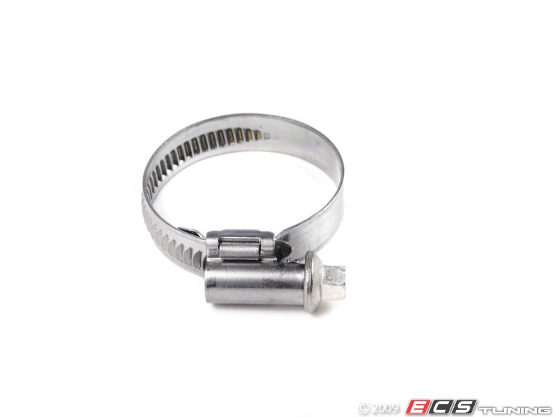

      Anybody has experience with these kits? Do I need to re-tighten/ is there a "break in" period?
      Also, do they require special hose clamps?

        There is no break in period. Regular hose clamps work fine.

            you want the kind with indented edges not the flat stamped kind, those will dig into the rubber.
