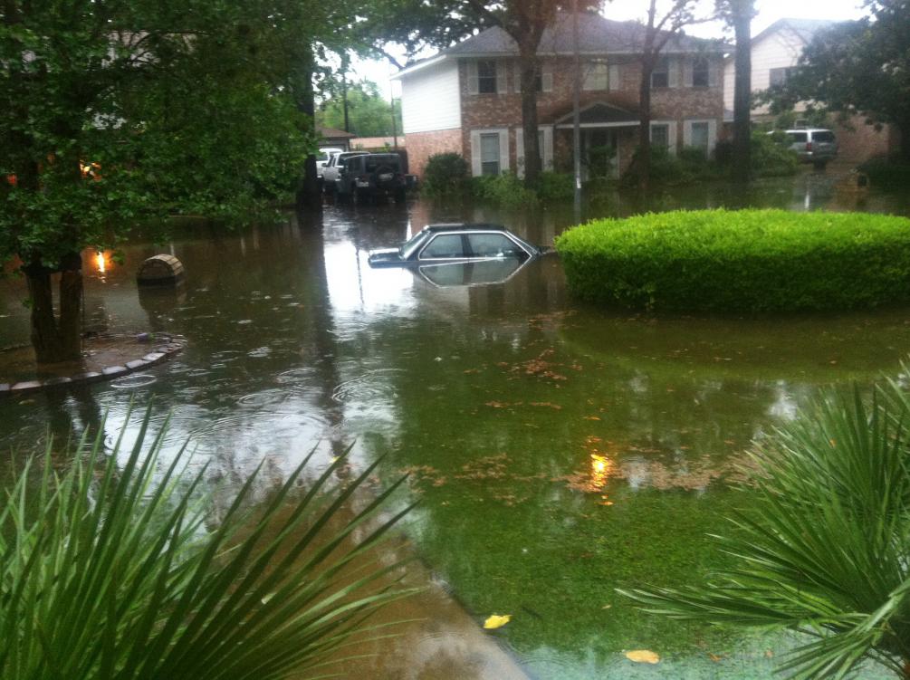

    Hello Texas getting hit hard by rain yada-yada-yada and this happened
    Car was parked when flooded (water up to the mirrors), drained the oil (water got in), fresh oil and filter, pulled the plugs and cranked the engine to get the water out of the cylinders. Everything seemed fine till I put in new plugs and tried to start it. Heard a sparking crackling noise coming from the drivers side closer to the headlight. After that the car won't crank anymore. All the lights and wipers work but when I turn the key nothing as if the batt is dead. Bought new ecu and abs module but still no crank. All the fuses look good any ideas would be greatly appreciated. Not sure if this was electrical so I posted here.

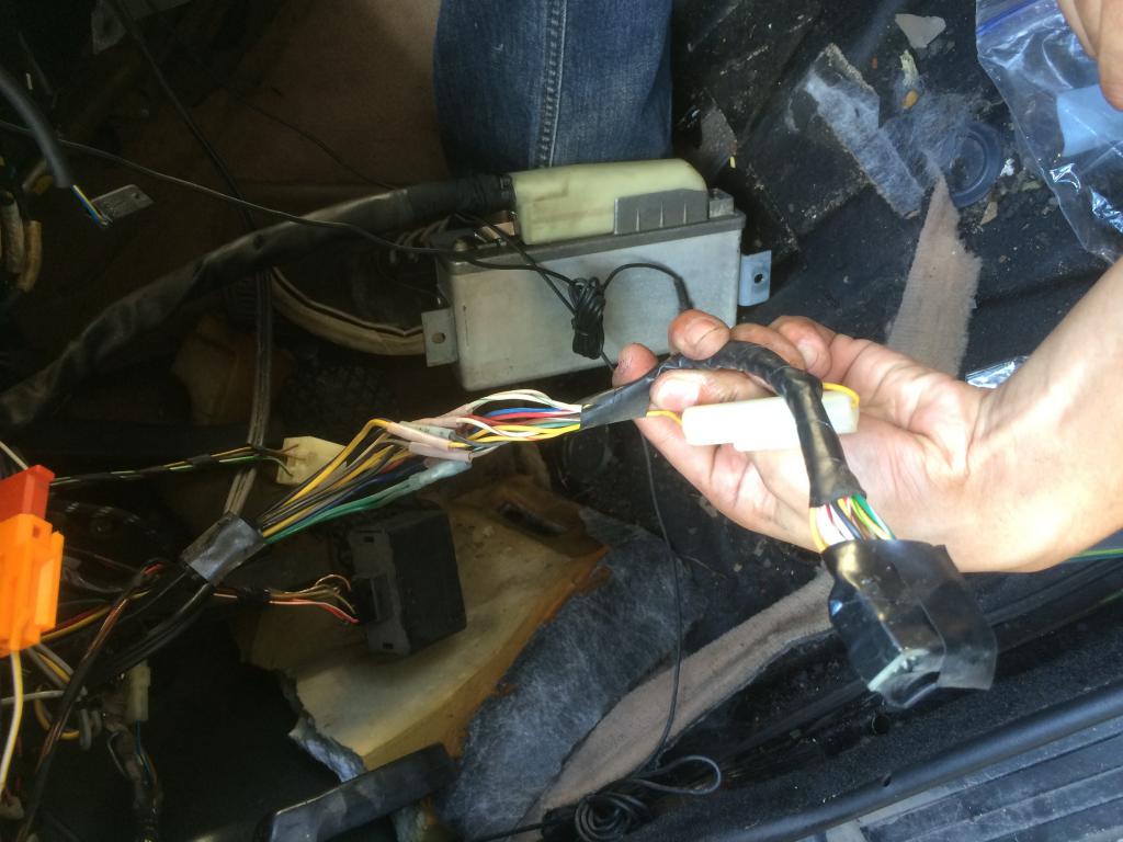

                              New ignition coil and checked the dist. Cap. It just still turns over but won't start. All the spark plugs are getting spark.
                              also found this
                              Seems like something like this should be connected to something. It was just taped off. Anyone know what this does?
