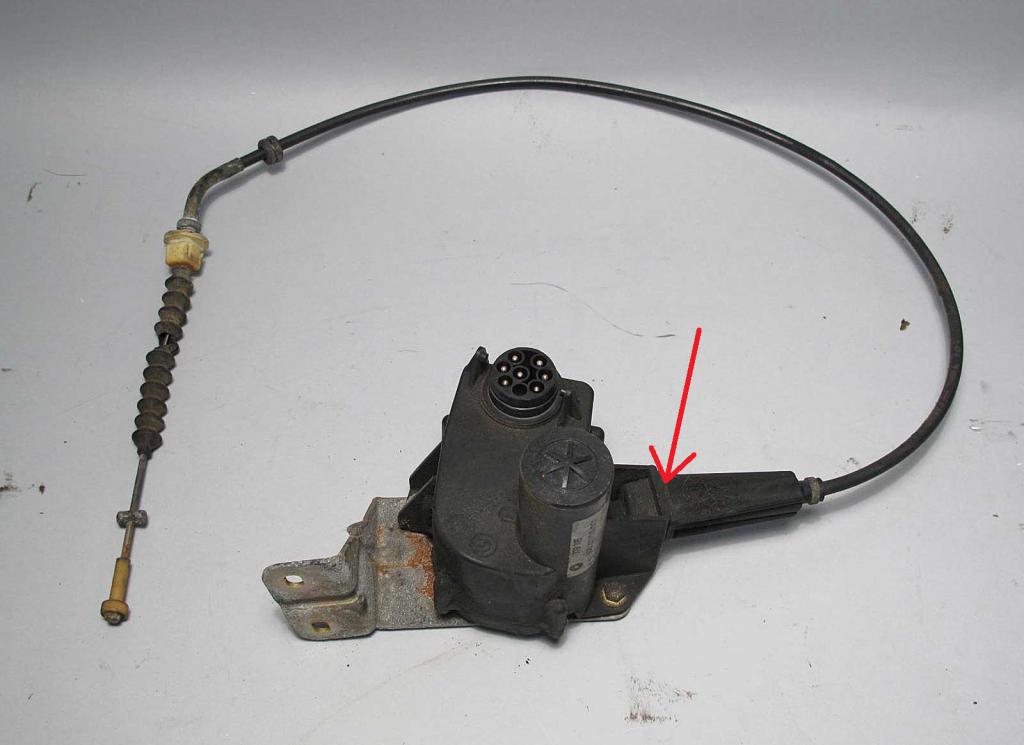

    You talking about the Bowden (push/pull) cable or 1 of the electrical cables/harnesses?

      If it's the Bowden cable push the tab at the red arrow and pill the cable end out. It should pull out the tape-like actuation part that the end of the Bowden connects to. Disconnect the old end and connect the new one (this should be self explanatory by looking at it).

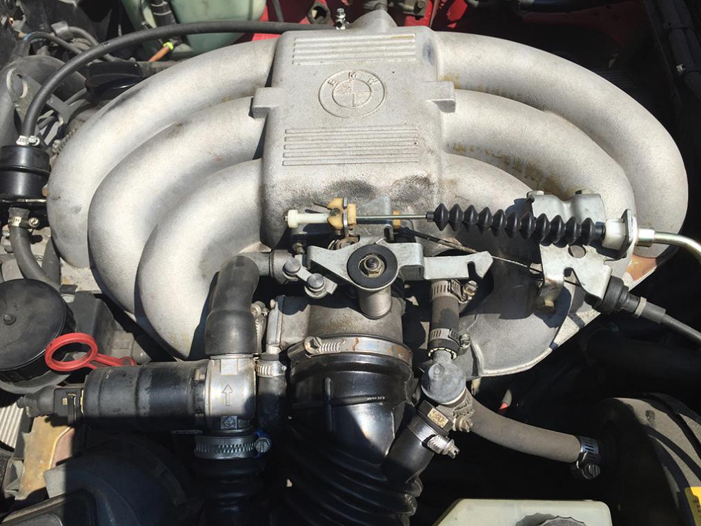

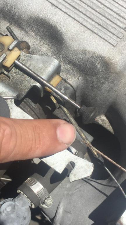

        I'm not sure which one it is but here is a pic

          Part number 65711386243?

            fixed
            CC working perfectly
