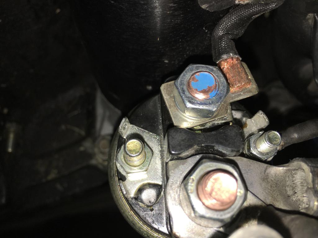

    Delayed on the post. By "that terminal" I'm referring to the little one on the right if the solenoid. Not related to your post above.

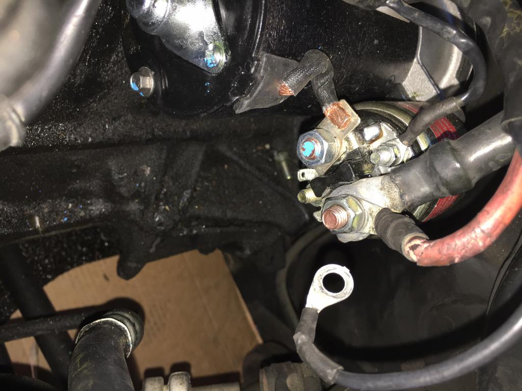

          Okay so I actually stumbled upon new info.
          So it is not the two larger cables causing the problem, its actually the black cable on the bottom.
          The car does not short out when I have that cable disconnected
          • BFT_Boyle
            • Jul 2016
            • 199
            #35
            Ok so that one you have disconnected there should be the one that gets power when you have the key in the crank position. That is the "signal" wire to tell the starter to crank.
            Does anything happen when you try to crank the engine? The starter shouldn't do anything.

                I couldn't help but notice that spade terminal is super close to the motor terminal. Are they touching?
                This would connect the starter motor directly through your ignition switch (bad)
                Sent from my XT1585 using Tapatalk
                • theserj
                  • May 2012
                  • 47
                  #38
                  Originally posted by BFT_Boyle
                  Ok that is good. The wires are not swapped then.
                  No it is not touching, that was a bad angle

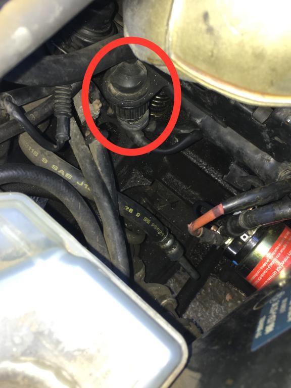

                          ***Problem Solved*** E30 Running
                          So I carefully inspected all the cables. As I mentioned, everything was in its proper place.
                          I had also cleaned the fuel injectors right before changing the starter, so I thought I may have screwed something up there.
                          I hate solving these issues because now I don't know where the problem was for anyone else to reference in the future.
                          So my guess is either of these two:
                          I rotated the part in the picture because I noticed it was loose.
                          I also unplugged the temp sensor and plugged it back in.
                          Thats all, then I went to start the car and no shortage at all. The problem has not returned

                              **Update**
                              So I took apart the instrument cluster to tighten the gauges. After reinstalling the cluster, this problem returned.
                              So I went back and disconnected that same bottom terminal from the starter that was originally causing the battery to short, and guess what, the car does not short.
                              How weird is it that this problem returned after I worked around the ignition?
                              So now my problem is that the battery shorts out when I turn the key, AND the alternator is not charging the battery.
                              Both of these issues I am guessing are being caused by some wiring from the starter?
                              • theserj
                                • May 2012
                                • 47
                                #45
                                **Problem Solved**
                                Replaced the engine ground cable on the bottom, it was worn out. This solved my problem if anyone was curious.
