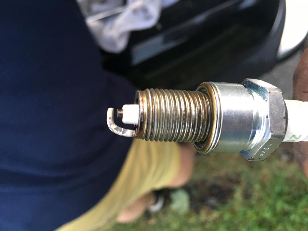

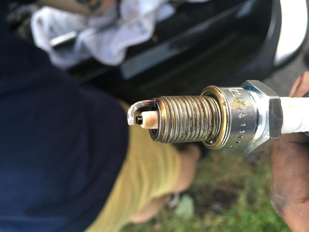

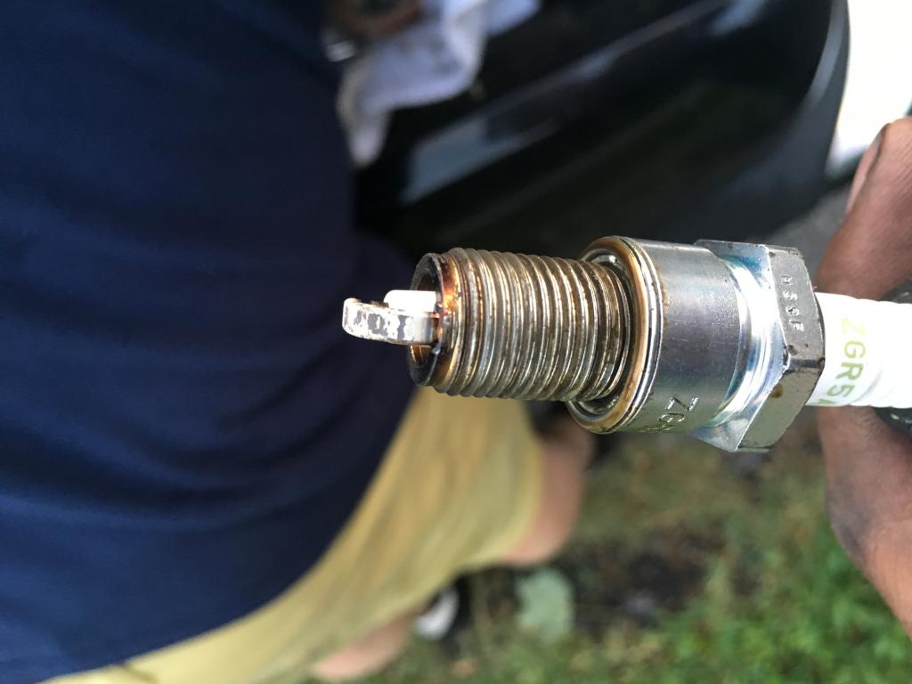

    I'm working on troubleshooting my sister's '88 325i and would love a little help diagnosing the issue. The main problem is a rough idle with some hesitation and stuttering on throttle. It seems to be running super lean based on what we've determined.
    The plugs plugs she had in it for a few thousand miles I think (NGK zgr5a) were straight up WHITE on the ground strap and insulator; new plugs made it run better but after four days they're already pretty white (not as bad as before but still).

      Sisters BF here. These are the plugs we pulled. Could burning coolant result in a plug like this? Car seems to be running fine with new plugs for the moment.

            A good general reference on how to read the color of the spark plugs.
            Your engine is running extremely lean. I would watch out for overheating if I were you. You could also potentially leak coolant into the cylinder resulting to the white calcium deposit on the plugs. Since you had very low pressure on some of the cylinders, I suspect that you will need to look at the HG for leakage.

              The trouble is determining if the white on the plugs is from a lean condition or coolant. So far nothing I've seen points to a fuel issue. Other than the o2 sensor (testing that is on the list) is there anything else that could cause a lean condition?
