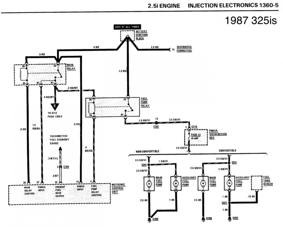

I am in the process of installing my rebuilt M20B25 in a 1987 325is and have run into some starting problems. My issue appears to be the fuel pump relay not switching power to the pumps. I have done some research on multiple forms and was hoping I could get some assistance with the troubleshooting.
I found the below noted guide and have made my way down the list, as documented below. My conclusion is the DME is not grounding pin 85 on the fuel pump relay, thus the relay is not closing. Could anybody shed some light on this issue?
Of note, I have tried using a completely different DME and have come across the exact same problem;

(I have jumped the fuel pump relay points 30 and 87 closing the circuit and functioning the pumps. Still no ignition on turn over, but fuel was smelled from spark plugs when removed which indicates the injectors are functional)
The fuel pump relay must have power on pin 86 (relay coil) from the main relay
output (pin 87) and power on pin 30.
(When key is ON, 12.5v to 86 RD/WT and constant 12.5v power to 30 RD.)
The DME will ground pin 85 to turn on the relay and power the pump(s) via pin 87. Of the above, only the fuel pump power is fused. So if the there's power at pin 87, but not at the pump, check fuse 11.
(When key is ON, there is NO power at 87, therefore no power at the fuse. This suggests that the DME is not grounding pin 85 to turn on the relay? Suggestions as to why?)

3) Check for continuity from DME 36 to main relay 85 (DME pin 36 to 85 GN continuity confirmed) and from DME 3 to fuel pump relay 85. (DME pin 3 to 85 BR/GN continuity confirmed)

(12.5v confirmed to fuel pump relay 30 RD, 86 RD/WH, 85 BR/GR... There is NO power to 87 GN/VI leading to the fuel pumps)
