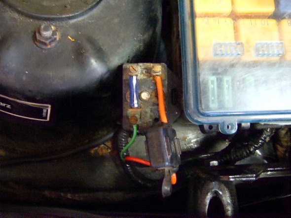

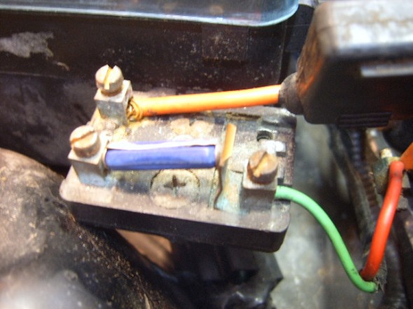

    ok here are somepictures,
    first, what is this?

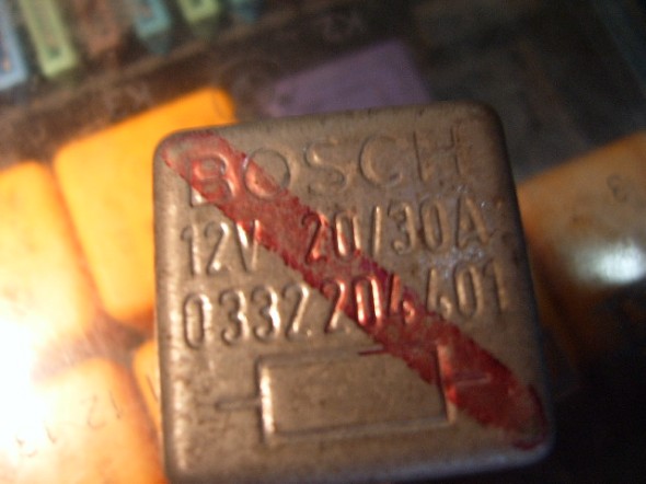

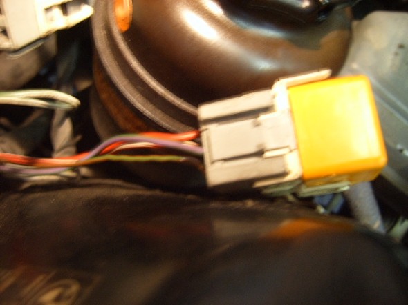

    and this rely Click image for larger version
    was pluged into this rely Click image for larger version
ID:	7103095 its been in the car for a few weeks since i replaced them. When i put in my new computer today to see if it was the problem ( which it was not) was the only time id cranked the car. went to go pull out that rely to jump the fuel pump and it was really warm?????
    • blazing
      • 274
      The thing in the first picture is the accessory fuse block.

                    anyone have any ideas why my rely would get hot?
                    • rcko
                      • Mar 2007
                      • 295
                      the main ignition or dme realay will get bit hot maybe more like moderate warm to the touch, but I dont recall them getting really hot
