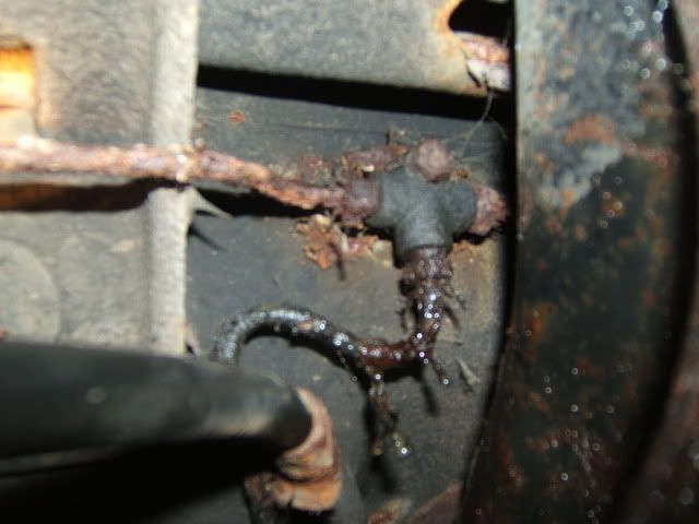

    Found leaking brake line, need some help.
    Well I traced down my leaking brake line and now it's the last item I need to fix to get my e30 roadworthy. I tracked it to the main line that goes into the "t". I was looking at the realoem diagram and was confused by it. Anyone got the part number for that line and does it go all the way up to the master cylinder? Thanks for your help, Andrew
  • mode
    • Jun 2007
    • 140
    OH MY GOD! that car is looking really sad..... I belive that that line runs over the gas tank, and along the left side of the chassis with the fuel lines.
    • rcko
      • Mar 2007
      • 295
      Mine was the same way and when I went to take the T off the line just busted. What I did to fix was get a new T, bubble flare fittings, and tubing. Then cut the OEM line at the nearest straight clean section with no rust and from there on rebuild the lines. It aint hard, just time comsuming. You can rent the flare tool and tube bender.
