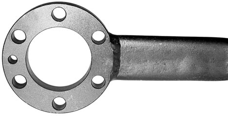

    Now I need to torque it back up to 300 foot pounds. Does anyone in Northern Virginia have a crankshaft holding tool that I can borrow.
    If not, does anyone have any advice on how I can keep the crankshaft from moving when I toque the bolt? I've heard someone suggest putting a prybar in the flywheel. Will that work? Will it cause any damage? Does anyone have any other ideas?

      You need the special tool. $47.70 from Pelican.

          I'd rather just buy the tool for $50. Much safer if you ask me.
