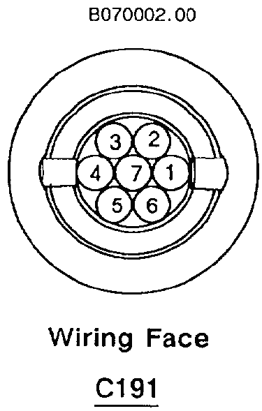

    Pin #1 Brown/Red – Coolant Temp Sensor +
    Pin #2 Brown/OR? – Coolant Temp Sensor -
    Pin #3 not sure what its for.
    Pin #4 Brown/Violet – Engine Temperature for ECU +
    Pin #5 Red/White – Injector Banks +
    Pin #6 Brown/White – Injector Bank 135 -
    Pin #7 Brown/Yellow – Injector Bank 246 -
    Brown sensor is for gauge
    Blue sensor is for the ECU
