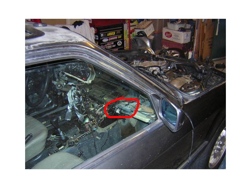

                Here's a pic of the car with the entire dash removed. I didn't see anything like the pic that you posted, Scott. I definitely looked. That is what the Bentley manual pointed me toward after checking the ICV.

                  Did you look under here? Should be to the left of the main computer...
                  • ecniv
                    • 44
                    Yep. I will look again on Friday when I get home. I'm going to feel like an idiot if it's staring me right in the face when I get there :)
                    Is it a part that is normally attached to the dashboard?

                              Hey, maybe the idle computer is gone... that would explain some things. Is there a multi-pin plug hanging loose down there, like a smaller version of the big computer's? I think it has about 10 pins on the connector. Actually I guess the connector would have the female ends. But you get my drift.
