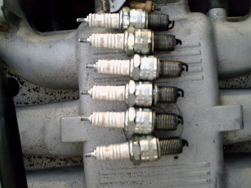

    ok so today i didnt run the car but i did turn it on and its acting worse then ever. but i tried to do some work to it. here is a pic of the spark plugs, sorry i couldnt get closer because then the focus would suck:
    i cleaned them and put them back in and here is a clip of the car running at its worse. sorry about the quality but the focus was all wacked out. when i show the end of the car im trying to show the smoke coming out, i also noticed that there is water and carbon coming out the exhaust. please ignore what i was doing close to the end:
    and well i took out the spark plugs after letting the idle for a little bit. and the came out all looking a little like how they did when i took them out for the first time since i did the tune up about a month ago, again im not sure if you can see anything but here you go:
    the spark plugs are champion brand, and when i tighten them down the dont tighten. they just keep turning and turning. so i just leave them hand tight and try to tighten them down. i wonder why....... i think i might go get some bosch spark plugs and put them in there.
    help me out guys....

              Uh... If running with the O2 sensor discounted didn't change anything, then that is your problem. If the O2 sensor was working correctly, the engine would run even richer when it was disconnected. No change means it is faulty.
              Also, spark plugs than won't tighten is bad. Sounds like the head is stripped out (how did you manage to strip ALL the holes?) and will need to be repaired. Loose spark plugs will cause all kinds of problems.
              Vacuum leaks cause the engine to run leaner, not richer by the way (more air = leaner).

                that does sound like a break through right here. the o2 sensor. but sometimes the car runs great and others the car just runs like shit or should i say, most of the time now. anyway, after all this im not sure if im going to keep this car anymore......
                i didnt strip out the holes. some previous owner was really pissed off the day he changed the spark plugs or something because, i mean, all six are stripped.
                no wonder when i disconnected the ICV the car would run a little bit better.
