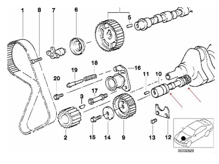

I am in the process of rebuilding a m20b27 block.
I am going to have it hot tanked so I removed everything from the block, including the two bearings that the intermediate shaft run on (the on that drives the upper gear of the oil pump.)
The problem I am having is finding the part numbers in the ETK.
Here is a picture of the part of the intermediate shaft with arrows pointing to the places where it runs on the bearings that are pressed in the block.
anyone know the part numbers or a place that sells them.
Thanks
Tom
Thanks
Tom
