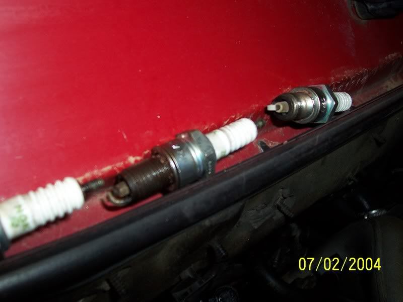

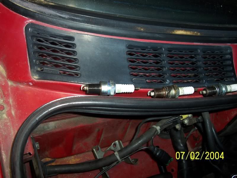

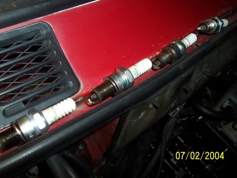

                            Also, forgot to post pics of the plugs. These have maybe 3k on them tops.
