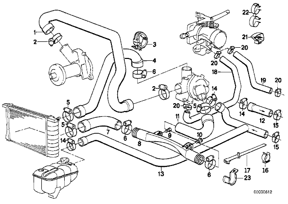

                  How about for a track car? Are there any events in freezing temperatures? I'm guessing not.
                  Attached is the diagram in question. #18 and #19 are the inlet and outlet.

                    Bumping an old thread. So which is the inlet? 18 or 19? and is that what I would hook up a flushing t to to flush the system?

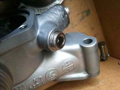

                      Here is how I set mine up.
                      Write up here.
                      This guide will show you how to properly bypass your throttle body heater. Parts needed spare thermostat housing spare throttle body plate 1/4-18npt bolt or plug m12x1.5 bolt m14x1.5 bolt 2 crush washers Tools needed drill press or hand drill various drill bits bench vise m12x1.5 tap m14x1.5 tap 1/4-18npt tap tap handl
                        Not sure which is the inlet, but I wouldn't flush from those lines as they are small.
