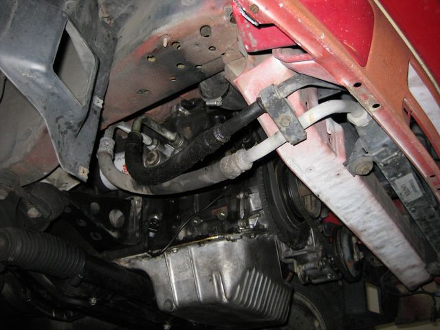

    One of mine is leaking and I was wondering if I could replace the hose portion and use 2 clamps instead of buying a new OEM one. Has anyone done this?
    Also, is this the correct order?? Mine are reversed on my 1/89 325is.

            This is what I'm talking about...is the order of the hoses incorrect?

              It really doesn't matter which way the hoses are connected, but that looks right.
