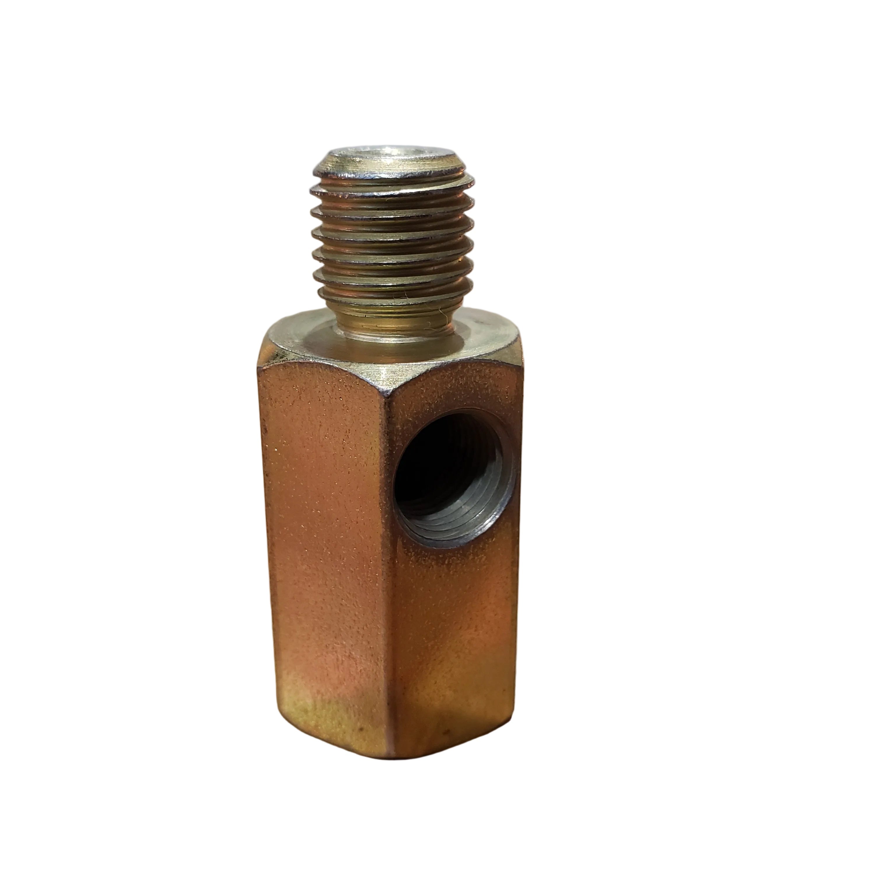

      or you can do it with this. they are currently out of stock
      Steel, zinc-coated M20 oil pressure adapter fitting. Accepts 1/8″ NPT. Run an aftermarket gauge or turbo feed while keeping your OE pressure switch.
          I just did that mod this weekend..... ebay has that adaptor for around $20
