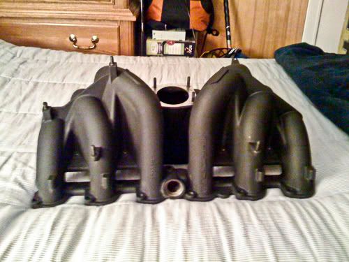

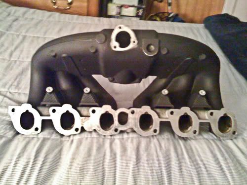

    painted intake manifold
    Last picture was taken today in better light after I sanded, shined, and polished the top part to make the logo stick out. The first ones are more what the color actually looks like. They're all taken on the iPhone so it sucks. I'll be doing the same with the valve cover once my rebuilt head comes in a few days. I'll take a picture in a week or so once it's running to show a final pic. All I did for this was clean it, do a light coat of high temp black, bake it at 400 degrees, repaint a heavy coat, and rebake it at 400 again until it smoked from the inside. Once it cooled and dried overnight, I tested it to make sure it was alright. It's holding up great and doesn't give into chemicals.

    Clean up the center a touch more and it will look alot cleaner. Very nice though.

      Black crinkle FTW:

        I had mind bead blasted or sand blaster(whatever they had) at a machine shop when they resurface my head. It came back looking like fresh aluminum. I sprayed it with clear and it gave it a little darker look. I dont have a pic of it and it is not put together yet. I like yours.
