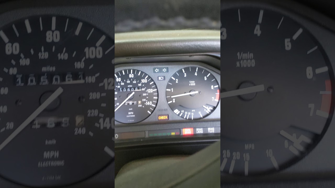

    Hi all, sorry for the post - Yes, I've used the search feature, I have my suspicions of what might be the cause of the hunting idle followed by completely cutting out. I'm hoping this video can help someone nail it down. I tried making my own homemade smoke tester. I think it worked well but i wasn't able to find a vacuum leak. Which either means i don't have a vacuum leak or the tool wasn't good enough. I did see that the smoke made it to the valve cover when i took off the oil filler cap.
    It is a convertible that had been in storage for about 4 months. It ran without issue for ~50 miles this season until this happened. So i don't think it is bad gas but maybe? I put stabil in the tank when i stored it.
    I'm fortunate enough to have another working e30 so i swapped the ICV and the air box. The "good" e30 still ran just fine. No change in the "sick" e30. Here is the video:
