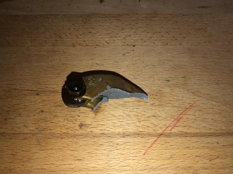

    I assumed a leaky fuel injector, and ordered up a set because, well, I was in there and the car has 240,000 miles with no evidence in all the records that the injectors have ever been replaced or cleaned. Since it was also in the plan to adjust the valves, I popped off the valve cover tonight, which is also necessary when you pull the injector rail. And . . . found this rascal under the cover. Intake rocker arm for cylinder #3, which kind of fits with the wet plug.

    I don't think I did anything during the timing belt and water pump that caused this, but who knows? I suppose I could have clacked a valve and a piston during the wrestling matches with the crank bolt, but I used hand tools and was pretty careful. Anyway, it looks like I'll be in good company, as there are lots of youtube videos about this very problem. Seems straightforward enough, but not what I was hoping to see.
