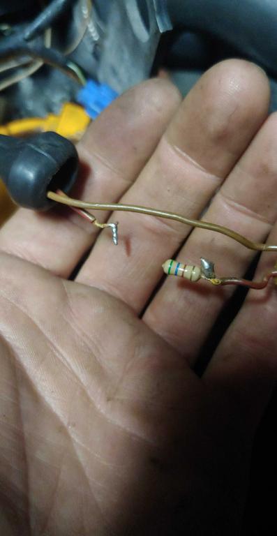

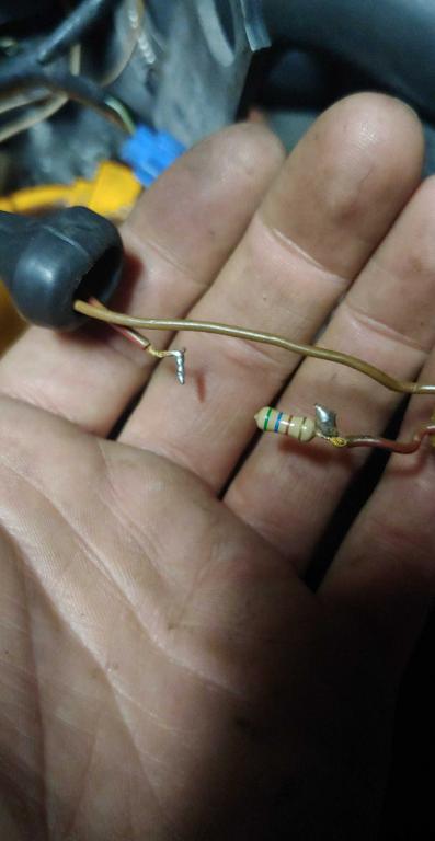

    Edit: Found it, PO had soldered a resistor inline with the coolant temp sensor (to fool the ecu into running richer/different timing I guess, car is one big hack job really) Wire broke, so I fixed. Runs beautifully, glad I bought her for the first time since the drive home.
