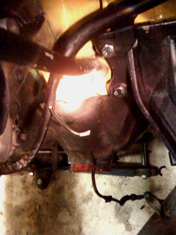

    I am using the m20 harness on my b35 swap. Apparently there are two parts to the m30 harness: 1. the main piece with inector rail, etc. and 2. the other that goes from the alternator to the starter. Will I need the second piece if using an m20 harness?
    here are pictures of the harness I am talking about:
    I am planning on getting it running today, so any help is appreciated!

    looks like the oil level sensor wire to me.

      I know what it is. I am asking if I need that harness if I use the m20 one.

        I dont think so... You should see the same connectors on your m20 harness right?

          you tell me. if the oil level sensor isn't hooked up to anything, what is the outcome?

            I think you missed the point of my original post.
            I got it figured out. Turns out that the harness is not needed when using an m20 harness. It is integrated.

              i think i did. I still don't understand what you were asking. Were you asking if it needed to be hooked up to run? I think it is just a dumby light on the check panel.

                no, the question was regarding the components of the m20 and m30 harnesses. The pictured wires are part of the m30 harness that goes from the alternator to the starter as well as some oil lines I never figured out . The m20 harness has these wires integrated in, rather than being a separate piece to the harness.
