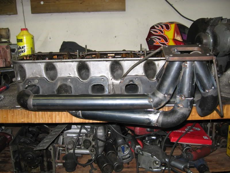

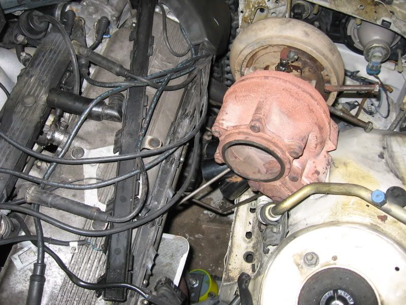

    Had a set of flanges laying around and with the swap car I am working on, figured what the heck lets make a manifold that will work with the mounts I made and A/C.
    Progress from this morning, should be done in 2 weeks or sooner. :)
    And will be making a jig to duplicate, any interest?????
    I used the HX40 to mock up since it's a large turbo so fitment will not be an issue if you want to use a smaller one.

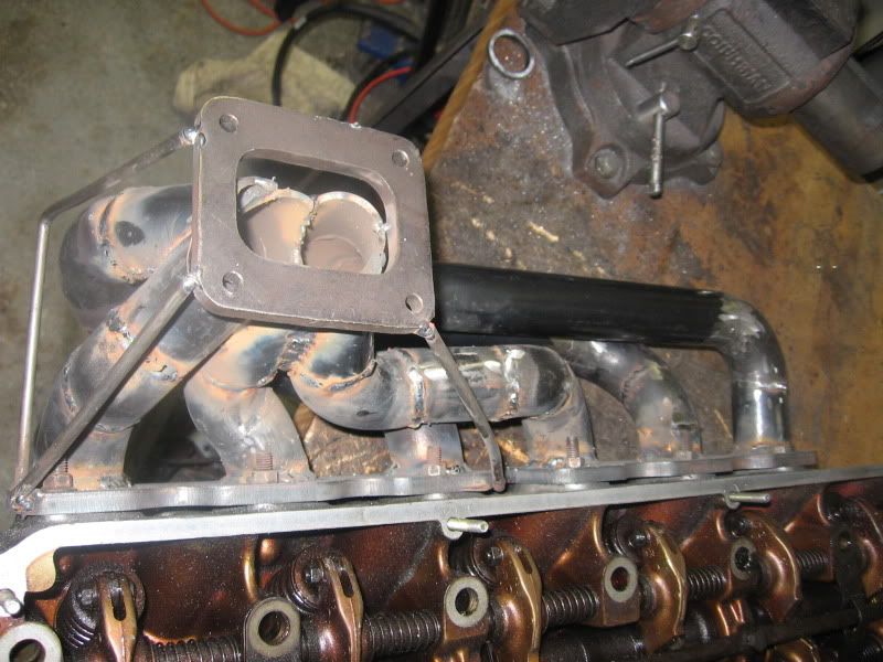

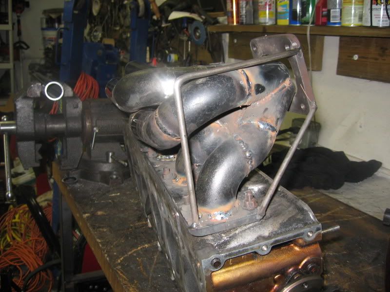

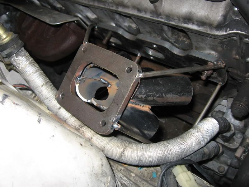

                  Had a few minutes to work on it today.

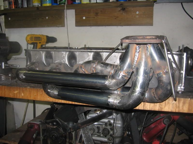

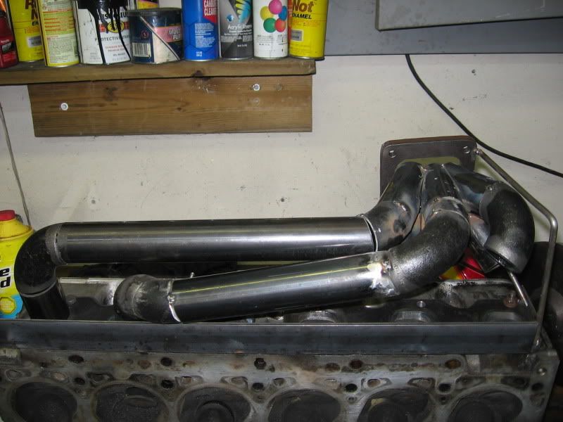

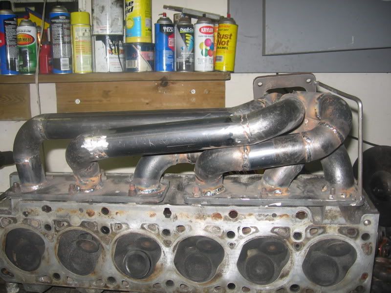

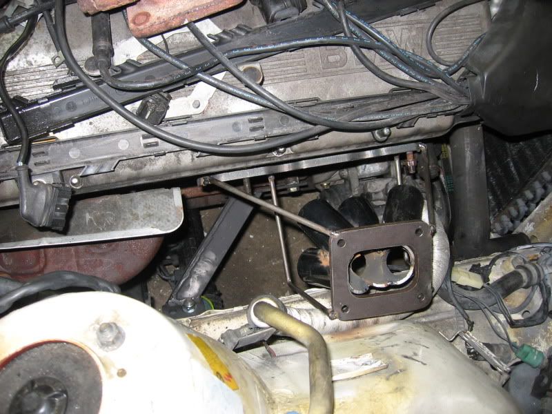

                      Almost done just need to add the wastegate provision and weld on the flange.

                        one Question
                        Excellent job looks good how do you feel the manifold will work not being equal length at high rpms keep us posted or just me I am veary interested.
                              Thanks
                              The manifold I am currently running is not equal length and it works very well at 7000 rpm's at 20psi.
