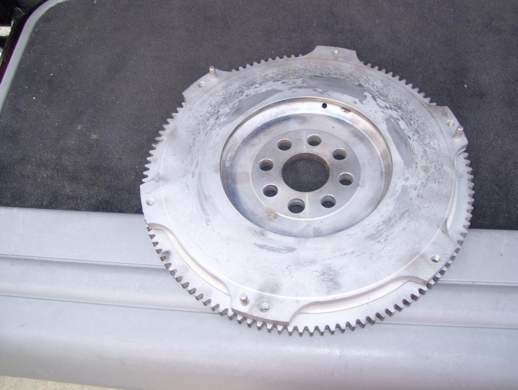

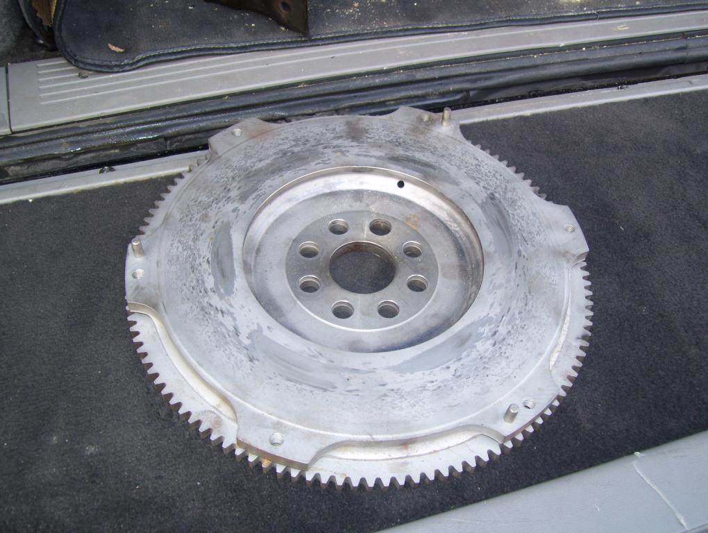

        Don't have an m5 one, can takes pics of 533 flywheel if that will help at all.

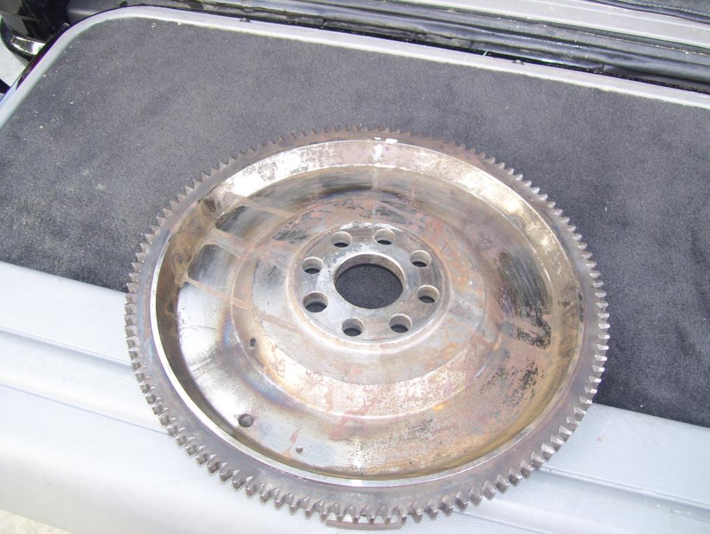

            here the flywheel that i bought from the junk yard . They said that it came from a 90 m5. icould return it for a 88 m5
            • Flash
              • 688
              That looks like a e28 533i/m5/ e24 633 flywheel in ADDITION to having those cutouts, so yeah basically its a modified e28 533/m5/ e24 633 flywheel. That one looks like its about 12 pounds.
              • ige30
                • 24
                it should work fine with an 1990 e34 m30 engine and a 260/6 tranny and use an m5 clutch kit
                • Flash
                  • 688
                  yes, all the m30 flywheels had the same stack height and 240mm friction surface, pressure plate stack height was the same as well (i dont know if they made a dual mass for the m30, nor do i care).
