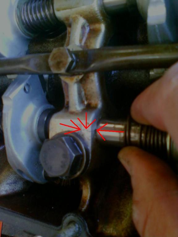

                    and i was checking the valve clearances today and noticed a crack in the head where the #2 piston's exhaust rocker shaft sits.
                    i am guessing that the pressure from the vavle spring is forced to the rocker shaft.
                    sorry for the crappy cell phone pic but you can get an idea of its location and size.
                    i don;t know if i should just take the head off, remove the vavles and take it to a machine shope. or if i should just run it till she blows. it wont be a DD car but i do plan on driving hard when ever i do drive the car.
                    Vic.

                      ^^^ warranty from the junk yard dude?

                      • vic_325
                        • 264
                        lol no, i bought it with an unkown condition.. because they didnt test the motor. so no warranty.
                        i am just going to pull the head, disassemble it and get it welded.
