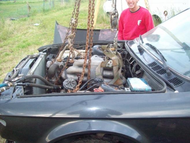

    So i have the m30 in my parts car and im ready to start making the mounts. i bashed in the firewall a lot and the engine is siting realy far back (was able to fit the engine fan and it barely clears the rad)

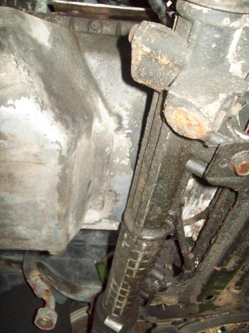

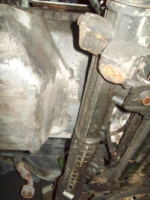

    the oilpan is siting on a 3/8" plywood on top of the steering rack. i have it back to where that little step before the "belly" of the pan.
    the problem im having here is the further back i go, the higher the front of the engine goes up following the curvature of the oil pan. Making the engine sit on a slanting anlge lengthwise in the chassis. I can jack the tranny up but it stretches the bushings on the e30 m3 tranny brace.

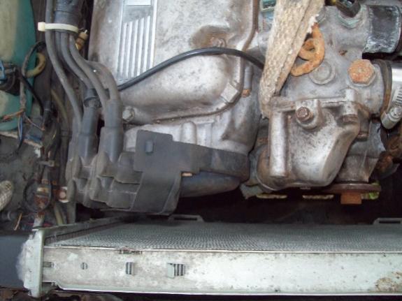

    Grab your radiator and a distrubuitor cap. If you have about 1/2 inch, you are back pretty far.

    3/8" oil pan-to-rack sound great. Make sure you can get your hood closed. I'm more like 1/4" and have a tiny bit of rubbing on the late model headliner/tps.

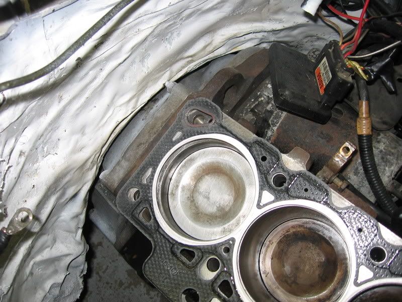

      This is the farthest back I was able to put it, with a lot of firewall and tranny tunnel beating.
      Clearances in some area's are an 1/8", pan to steering is less than 1/4"
      Your making the mounts yourself right?

        thanks for the responses guys. and ya ill be making the mounts. ill try to get some pics up asap

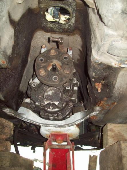

          good & tight, i had my engine just about that far back aswell. but the front of the engine sits too high up. just wondering if you drove the car in that position? did you get the engine to sit level, lengthwise. even with my m3 trans brace in place the engine still sits tilted back and im wondering if there will be any oil flow issues from that.
          i took a look at the e30.de stuff. id like to find some more examples still.

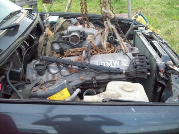

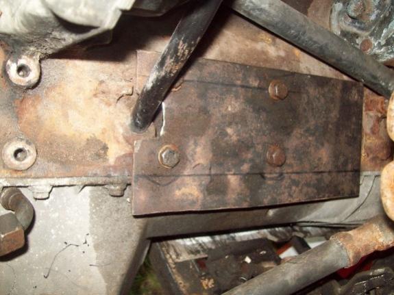

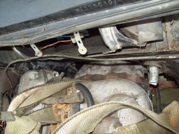

          here are some pics of where im at right now.
          • vic_325
            • 264
            some more.
            lol dont mind my bro
            i dont like how low the rear of the engine sits

              You have to beat the tunnel in more to get it back farther. Made my own tranny brace so the engine sits more level.
              These pics should give you an idea how much it was beat in.
                    Holy crap - you really went overboard on that. I'm sorry, but that looks painful. I wish I had pics of mine. You can hardly tell it's pushed back. And it's only 5 or so inches, not the whole firewall.
                        how close is the drive shaft to the top of the tunnel with your tranny brace?

                          The drive shaft is very close, the top of the tranny just about touches the tunnel.
                          Car feels well balanced, even though I don't rip it through the twisties car does not feel nose heavy.
