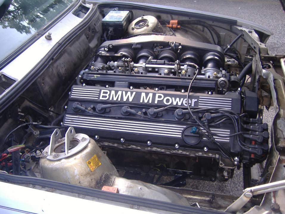

    finally got my s38b36 in.Time to get started on the turbo manifold.

        WOW look at all that room behind the engine?!

            Looks like you may need to redo those mounts.
            No radiator room and tons of by the firewall.

              i live on long island.Should have the 304 steel pipe this week to start the manifold,this is going to be my first turbo manifold so it should be intersting.I have had a turbo m42 and stroker m20 turbo,but this should be the baddest.

                i was going to knock the firewall back to move the engine back,but in this position its easier to work on the motor and if i had to pull the trans i can get to the upper bolts easier,but your right most people do set the motor further back.
                    where are you going to mount the radiator?

                      but seriously, are you going to tuck a custom rad under the rad support? your so far forward...

                          radiator is going to be custom and will be mounted where the a/c condensor sits,but i am looking for a standalone so might be removing the distrbutor and going with 6 coils but got to see how my funds are.Will be removing the head to go with a thicker head gasket.The engine already has motorsport cam gears and ecu chip.It was going to be just a engine swap but saw bembub turbo s38 and said that is a bad ass ride

                              what are you doing for brakes, converting to E28 style MC?
