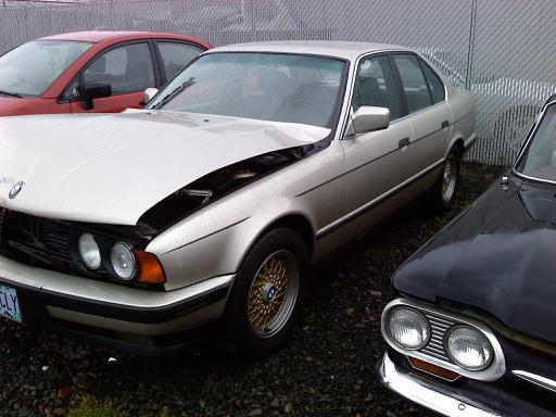

                    I'm getting excited now. I went and looked at the e34 again today and it fired right up. my old shop used to do the repairs on it so i printed off the service records. new cap, rotor, plugs, water pump, t-stat in the last 3k! interior is perfect too. I have a friend with 2 e34s and he is going in half on the donor car with me. the car was only 500 so i am only out 250 for the package.
                    Heres a pic of the receiving e30:
                    And the donor e34:
