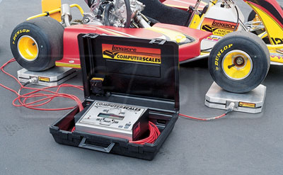

                            No mention of fuel quantity? There should be a standard amount in the tank we weigh a car at. Say half a tank on the indicated that way given the early/late we can figure pounds per gallon and subtract that.
                            Next question is how accurate was their scales? Truck scales or were these wheel scales for corner weighting a car and even those have a + and - percentage.
                            Edit: Missed the Half tank of Fuel in the edit before I read the post.
                            • Jean
                              • 18228
                              These were corner weight scales (similar to longacre type scales), they were turned on and zero'ed before putting the car on them. Not sure what %, but this same shop builds spec e30 cars everyday.
                              Like these, but wireless :
