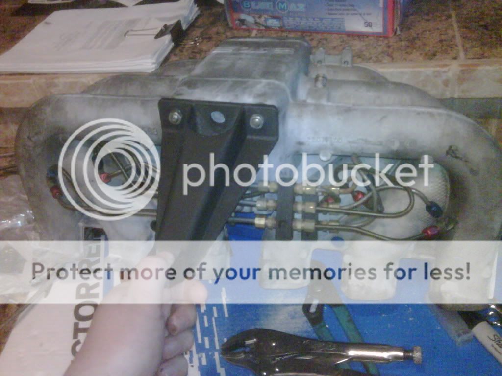

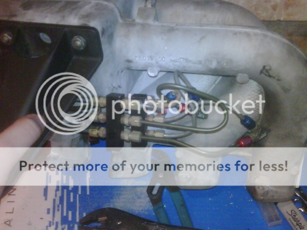

    well I have made a little progress on my manifold. Now i just need to pull the lines back off and drop my new jets in, and then paint everything black.
    From the top side you can't see any of this.:drink:

            very nice i was thinking of spraying my m30, I am using the older banana style manifold

              This. Is. Cool.
              I can't tell from the pictures, but did you just drill and tap? (what the thread/pitch BTW?)
              Love the hidden install! Hats off. Please take ore pics as you go along. In fact, grab a roll of duct tape and strap the camera to your hand while working - I want to see more of this.
                Oh and this:
                george
                i did just drill and tap it. the tap is a 1/16" x27 npt I have a spare if any of you guys want to borrow it for an install.
                i am doing this along with a 8.5 lbs flywheel and carbon/kevlar clutch in the car
                i'm hoping it will hold up. The controller I'm using will be a progressive rate so I'm hoping to keep wheels spin down.
