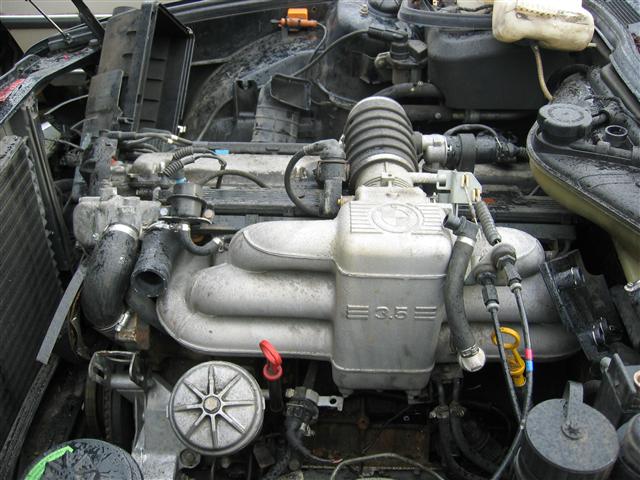

        Worth a shot, take off the valve cover and make sure everything looks legit.
        The engine will run off your late model harness with a little modification for the fuel injectors. You will need to find a B35 Ecu however, but the forums are your friend for that. Make sure it has its oil pan or you will be hunting for another B35 one. Good Luck!

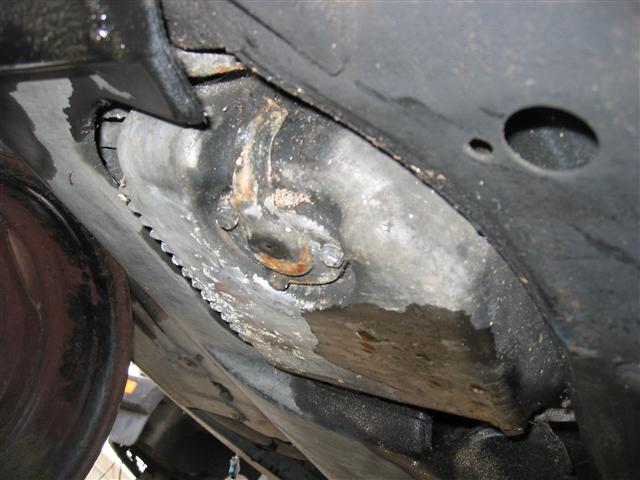

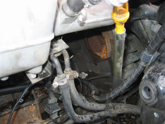

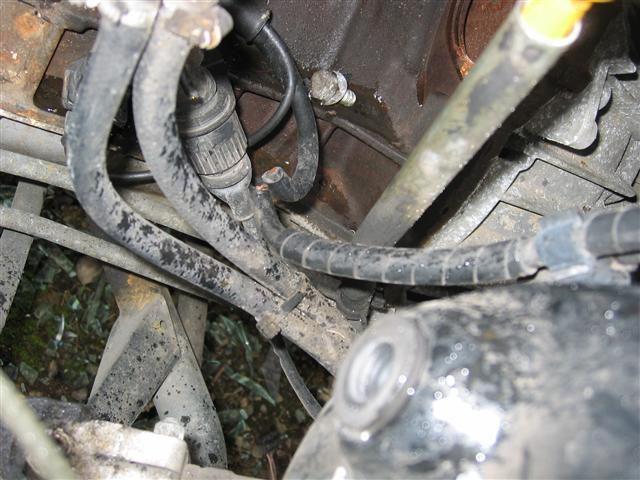

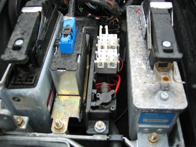

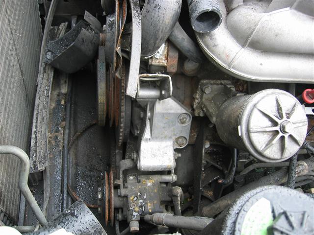

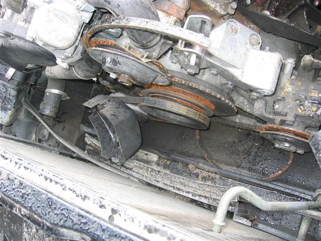

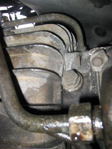

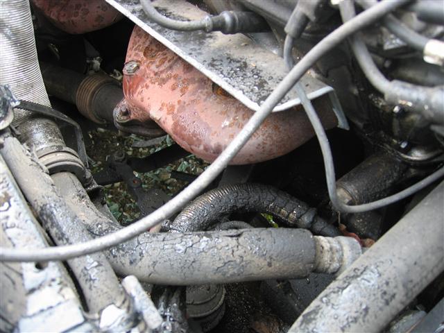

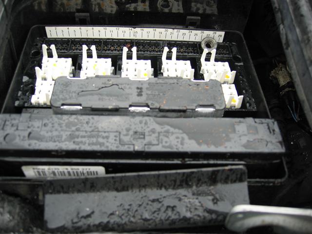

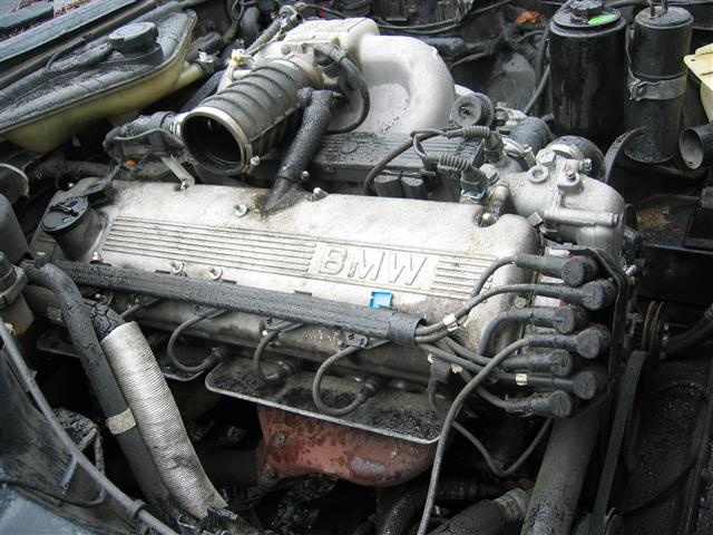

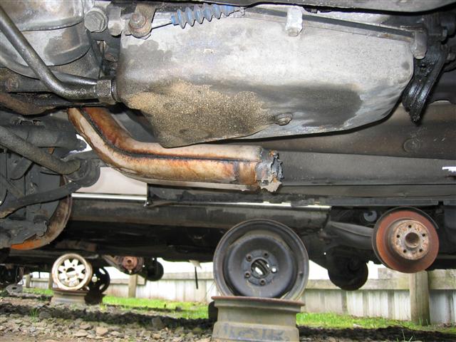

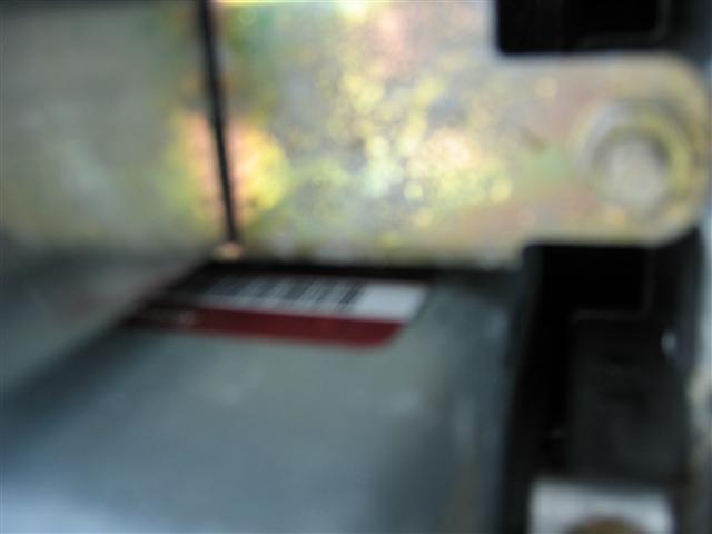

          Took some pictures in the rain today, 179 ecu, exhaust has been cut just south of the headers, driveshaft is already gone. Harness looks mostly complete. As mentioned earlier, the alternator/starter/intake/maf are all missing. I did see another m30 starter on an old 528 that I might steal and add to this long block.
          Anywho here are the pics of what the yard manager calls a "core engine". Pics will take three posts, be patient.

                i dont see why not if everything you see there that is visible is missing. i would just do the math of how much everything would add up to be and make a decision if its worth it.

                  You don't need any of that stuff on the driver side, honestly I would pull it and grab another starter/alt/afm from another m30 car to make it complete. They always cut the downpipes before the cat to remove the cat. Fact that the driveshaft is gone only makes it easier for you to pull the engine/tranny out as one unit.
                  When I got my b35 it was missing an afm and/or starter IIRC, I just had them write on the paperwork that it was missing and I came back for it another day since I paid for a complete engine with accessories..

                  "Should I buy it? I think if I've read everything right, I don't even need it's electric harness and I can just use the m20 ones from my 89 325i (computer too?)"
                  Personally I like the b35 harness as it fits the engine perfectly and looks better as well...and no you don't want to use an m20 dme, get the 179 dme.

                    Pop the valve cover off and inspect the head. Check for broken rockers, light colored fluids, or bent shafts. I bought a refurb'd alternator for $120, though it was with an $80 core charge. M30 AFM you can get from an e28, e24, e32, or e34, they are all the same.

                      Also check the plugs and turn it over.
