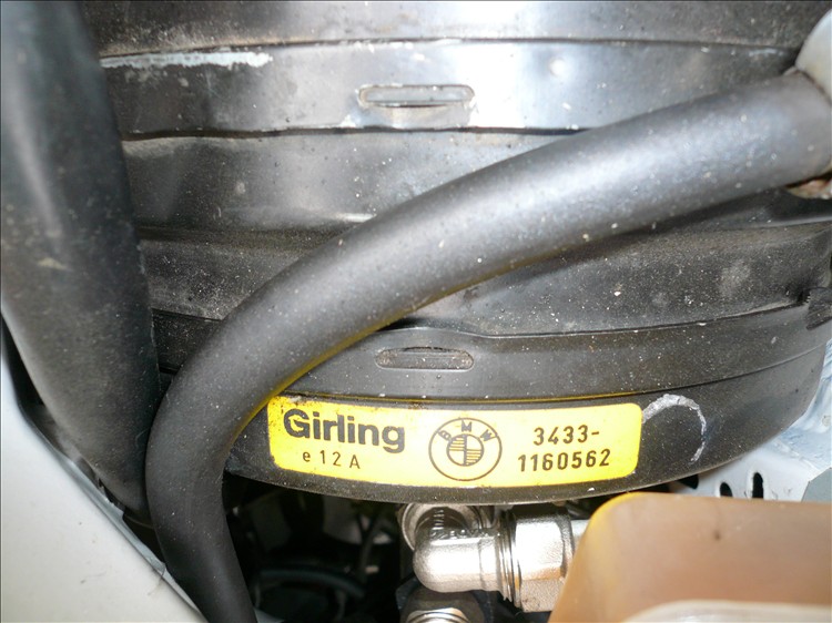

        Don't know the answer to your question, sorry, but does your plenum hit your brake booster? Which plenum are you running? I just bought some s38 throttle bodies for my car and I think this is going to be an issue.
        I guess what I'm really saying is: Pics please!! :)

            Regarding the brake booster, stock would not fit, so I bought a smaller one. I'll take pictures for you to see
              This is the info I was looking for, please let me know which one you used, VW? You should definitely post pictures though, not many s38 swaps on here

                Instead of using a VW booster, why not move the booster behind the headlight like on the 530/540 cars? Still no room?

                  My brake booster is from a ... lol.. citroen saxo... :-) It's the best fit with minimum changes :-) I've not tried it yet, but next week I hope everything is ok and I'll try it and post here.
                    oem E34 M5 booster + master drilled/slided the hole 1/2 an " to the left,, it is narrow but works superb
