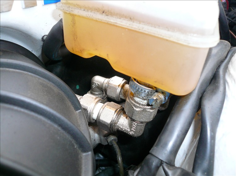

        9) be aware about the Steering pump,, and pay atention,, ALL E34 M5 have SLS/NIVAU regelerung (( self leveling suspension )) therefore there are 3 output on the pump
        1 in 1 out and one 1 for rearsuspension,, inside the pump there are pistons that pump the fluid to the rear ,, pill them out,, if not ,, there is a SURE result for overcooking the pump
        You must mix together the e30 steering unit with the S38 pump unit

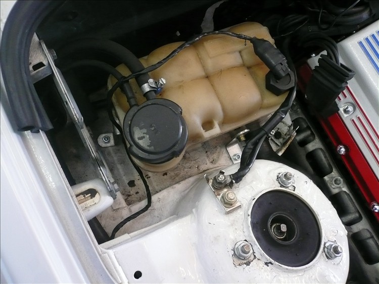

        Here is a picture,, and you must connect 2 of them together,, look how i had it done ,, on a hydralic shop,, take all the oem pipes with you and measure it up,, it would be best that a pro man who knows about this would take a look first
        10)The radiator.. make it out of a heating element ,, and the radiator must be located behind the kidneys and inside the frame of the car ,, CUSTOMBUILDT,, totally
        11) cooling fan is an E34 540 A/C fan,, going reverse,, and it is superb,, you must figure out how to get the fan to run,, when temp is up on the right turning point
        12) use THR balljpoint,, for clearance of the exhaust,, you can not use oem

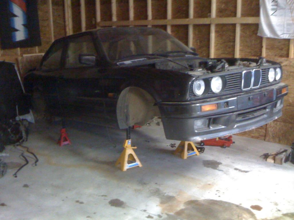

                      I have been going slow on this swap lately, been busy with other things, as well as doing my research. I have the E30 MtecII engine bay gutted and cleaned up, removed the front subframe and getting it ready to paint, as well as powder coating the E30.de mounts.
                      The M5 donor car has been gutted and scrapped. The S38 sits on my garage floor waiting to get installed. I carefully undid all the wiring and labeled everything. There was a strange heavy module I wasn't sure what it was for by the DME. I will post pictures/part numbers to see if I need it or not.
                      I am waiting for poly motor mounts to arrive and I will test fit the S38 in the bay and start massaging the firewall.
                      I am sure I will have more questions as I go along.

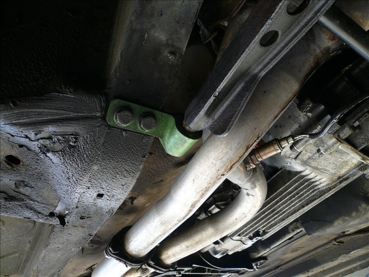

                              Originally posted by Sharino
                              Alpina, did you have to cut up your exhaust headers much? Any more pics of what you did there?
                              Very very good Questione,,
                              no need to cut the header,,,,,,,, except just where the collector ends,, the oem pattern with flangs and bolt had to be removed,,
                              seen here..,, but not a perfect picture
                              WHY ?????????? THE TUBES WILL ALWAYS ,, go to the direction where the controlarm-bushing is located,, so i reccomend THR ,, it is actually a must solution
                              Good luck with your project
