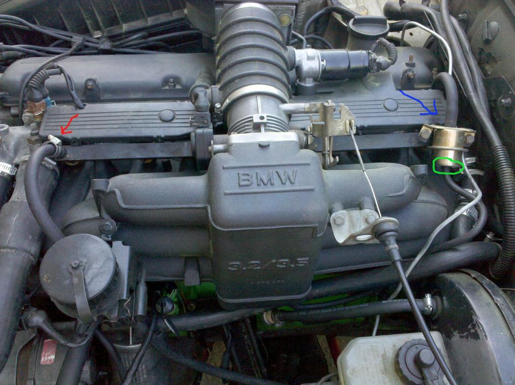

        the fuel makes it to the fuel filter fine, through the filter itself fine. where we get stumped is here: why isn't it making it all the way to the front? How could I check, like you said, to see if the head is weak? (and that's why it's not making it to the fuel rail)
        I did not change anything on this car so far. I just drove it to a friend's house hung out there for about an hour and when i tried to start it, it just wouldn't.
        so this makes me wonder if i should even try to fcuk with the FPR hose configuration the PO set up during the swap. It was running fine for the whole week and a half i drove it.
        the red arrow is the one that comes from the back. we blew air threw it to make sure it wasn't clogged, and it wasn't.
        the back half is where i'm a bit confused. shouldn't the blue be the supply ?

        any more pictures you guys might need to help out let me know and i'll gladly take some more. thanks for your time!

            red arrow is the supply line form the tank
            jump the relay out and see if the pump will run.
            also check to make sure the spark plugs are firing (this will tell you if the injectors are firing)
