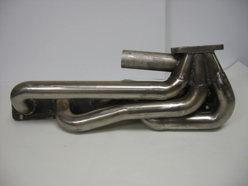

                        • Good & Tight
                          • Apr 2004
                          • 2057
                          When using the stahl head flanges weld a piece in between the flanges to keep them from moving. Like this

                          • LowR3V'in
                            • 4209
                            Are you going to do a header, or adapter?
                            • Lurker27
                              • 821
                              Otis,
                              I was planning on just bolting them to my spare head (it's busted beyond repair and I got it for $25)...will that be OK??
                              '89 335is +turbo
