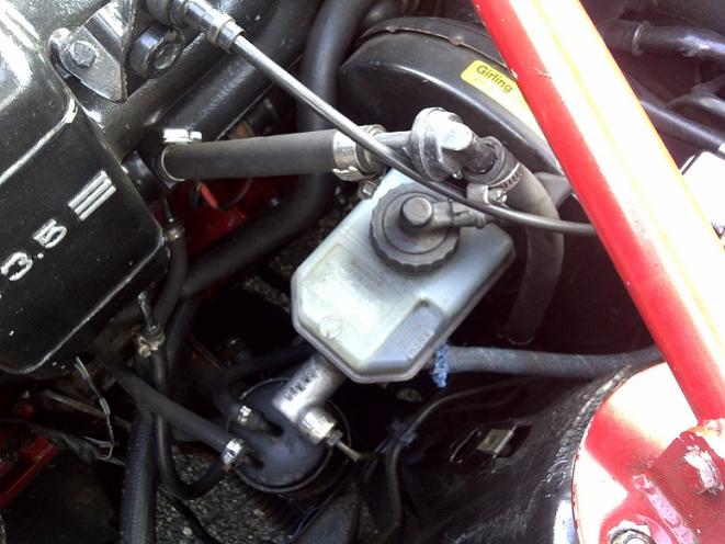

Working on getting my m30 swap done and it is running rough. I dont know how to really explain it, but to start it I have to give it throttle, and when it starts I have to stay on the throttle to keep it running, but it revs, then drops, then revs, then drops, etc. Sounds like a huge cam at idle (which it has), but I am revving it up where it should smooth out. At first I thought it might have been the cam sensor but I just replaced all the plug wires and sensor. The only thing not hooked up is the o2 sensor, will this make that big of and effect?
Specs on motor/swap:
m30b35
292 cam
miller maf and WAR chip
m20b25 harness
new bav auto plug wires with cam sensor
Thanks.
