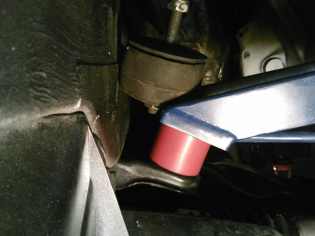

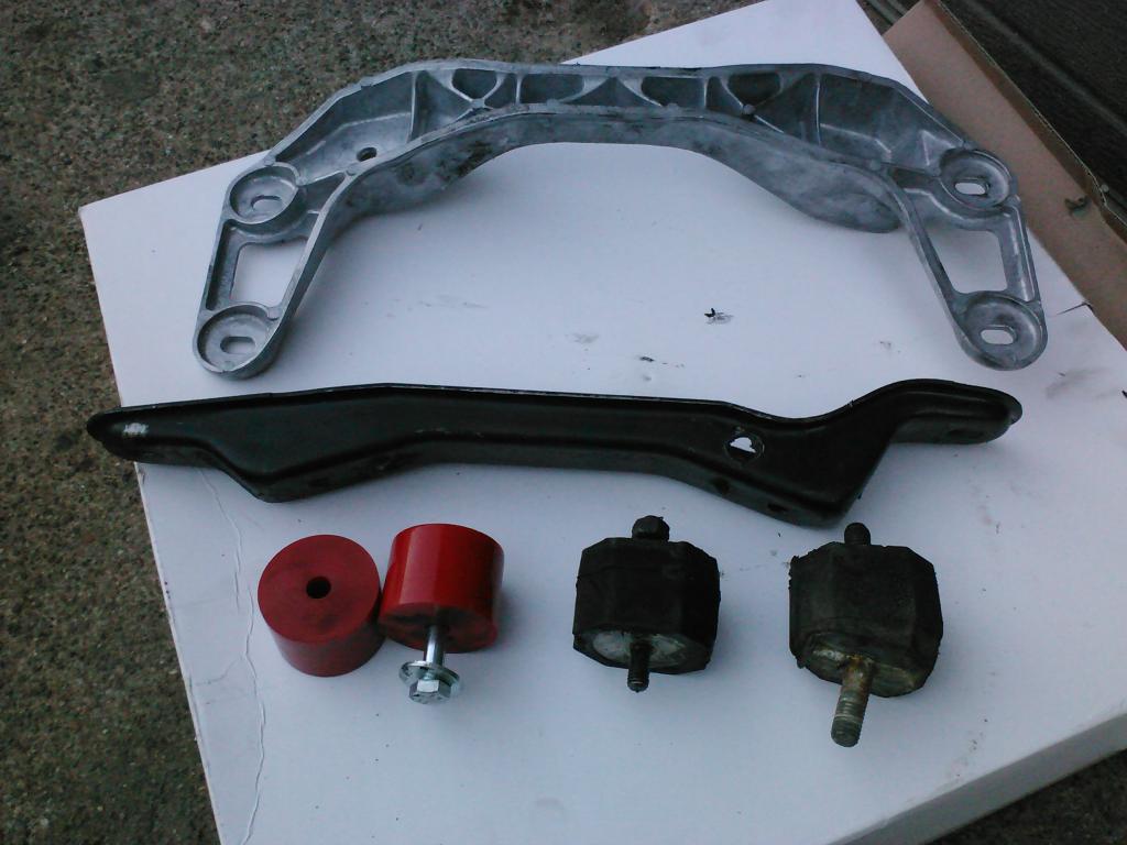

Hello guys,
I'm currently doing the common M30 E30 swap! Alright this is what I have, M30b34 with a Getrag 265 with e30 M3 tranny cross membrane and E30 polyurethane mounts. I also have polyurethane motor mounts so when bolted on tight it doesn't allow my tranny to fall down. My problem is the polyurethanes for the tranny are not tall enough!!!
What mount should I use for this? Where did I go wrong?
I also inspected the E30 mounts and the E28 mounts and they are the same height, should I fabricate something or is there a mount out there that I can get? thanks
